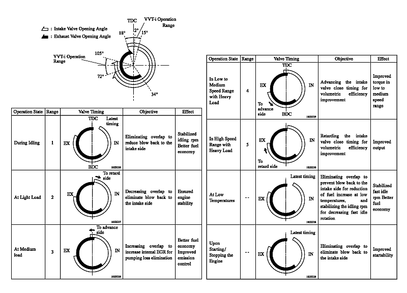

I know car guys works a lot with cams-/valve timing. Maybe we should check that on our sleds too? What happens if the camshafts chain is loose?
Some pics to Illustrate
