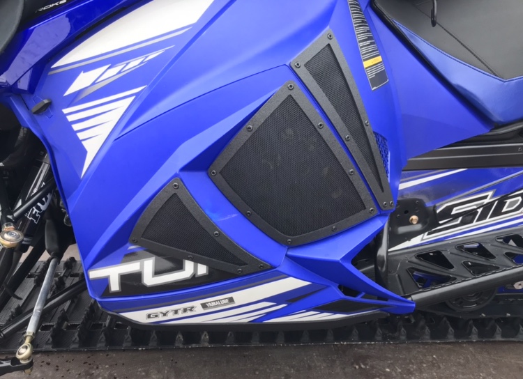

Has anybody vented the exhaust side of the sidewinder like you do on the clutch side or does to much air flow on that side create a problem, Thanks Kurt
AnythingButLast
Have the moflow vent kit on mine. Both side panels have the rear 2 large vents. Clutch side I have the additional front panel frogzskin covered vent. You will never create and air flow issue from "too" much venting. Vent away!

can you post a pic pls.Have the moflow vent kit on mine. Both side panels have the rear 2 large vents. Clutch side I have the additional front panel frogzskin covered vent. You will never create and air flow issue from "too" much venting. Vent away!

I will post some pictures when I get a chance. New phone since winter so all my photos are in the old one. Will have to transfer them when I get some wifi.
I installed the 6-piece set from Moflow with prefilter on both left and right side. Nice kit - much needed if you do alot of boondocking in deep snow.
