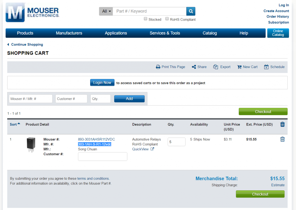

These are the exact relays that are in our vipers.I purchased this five pack and now keep with me on my trips.
Thought you guys should know.

I thought I recall a thread where GrizzTracks suggested the "Sealed, Washable" version of that relay - with the hopes that they would provide more protection from the elements and freeze up. I was just thinking about ordering some of them, actually. The part number is slightly different: 303-1AH-S-R1. I don't see the Sealed, Washable ones on Amazon, though.

I've posted this before: The mechanical relay being used is "Flux sealed" but there is an option in this series for "Sealed type washable" which I would think is more suitable for snowmobile use. The relays being used in the Viper have a manufacture's part number 303-1AH-C-R1-12vdc for the "Flux sealed" and if you replace The -C- with -S- so the part number is 303-1AH-S-R1-12vdc then you get the "Sealed type washable". Mouser has these relays at a reasonable price.

I ran the "washable/sealed" relays last year in Canada with -20 to -30 F temps and so far no problem. I don't believe they've been adequately tested yet but if you want to carry spares why not buy these as replacements? The stock relays are known to have problems in cold temperatures so until these "washable/sealed" relays prove to be no better than stock I think it's an inexpensive option worth trying.
