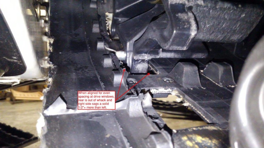

I see this is an old thread, but I have a couple track alignment questions so hopefully this thread works for asking them. 2015 SR Viper M-TX 162, 366 miles on odo, just bought it, have never owned a snowmobile previously. Bought it to get more access to ski backcountry in Washington, it will be a 2 person machine. Please bear with questions that might be fairly simple, I have exactly one ride under my belt- ski buddy and I ran it up to Mt Baker last Saturday for some spring skiing on the mountain.
At the end of the day I noticed there was some black water staining coming from a riveted seam on the tunnel and a quick look underneath showed that the track was riding much closer, and rubbing slightly, on left side. So I figured it must need a quick alignment to center things up. Back at the my shop I suspended the rear to take a closer look and find that the track at the front is indeed off to the left side and that the drive gear teeth on the left side are not centered in the track "windows" and the little stainless clips are digging into the drive gear /cog. So I break out the wrenches and adjust the alignment till the drive gear/cog runs in the middle of the windows which also puts the track fairly evenly spaced in the tunnel. This seemed to "free up" the track as when I started the track would not spin at idle, but when idling after adjusting the track would spin right along. And the track ran quieter after adjusting, no clacking coming from the front where the SS clips were hitting the gear/ cog on the left side.
But, this seems to leave the track unevenly spaced in the back, and the right side is looser than the left. Probably 1.25" sag on right side in the middle and maybe 3/4" on left side. No weights on track, just rear of machine suspended.
If I align the track at the back and make sure the spacing at the hyfax is dead centered and sag is even on both sides then the track rides off to the left in front and will rub on tunnel and the SS clips really seem to whack the gear/cog.
So, align for even spacing at the rear or at the drive gear /cog in front?
Thanks for any expert knowledge

I've never gotten it 100% right, but I've always had 2-wheel setup at the rear.
You could x-measure the tunnel and the boggie in case there's something off there.
I never worry too much about this, I just align the rear so there's minimal amount of wear all over.
My driver wheels have been worn down a bit but it stopped eventually.

10-4, I suppose just align as best as possible and aim for no track rubbing on the tunnel.

I don't understand the track alignment issue?
Set track tension.
Spin track to see what side has the largest gap between hyfax & clips.
Loosen axle nut, on that side only, tighten adjuster bolt a couple wrench turns, re-tighten axle nut.
Now this is key...manually, by hand, turn track forcing it so it's totally mis-aligned to the other side.
Spin track.
Observe if it comes back. If so, loosen axle nut on that side, tighten adjuster a little more, re-tighten axle nut.
Repeat until you find a happy medium. Track Will dance, side to side, a little.
We just don't want it totally slammed to one side.
10 minutes tops and you're ride ready.
First ride, I bring wrenches with in case a minor field adjustment is needed.
More times than not, it' fine as set on the stand.
Set track tension.
Spin track.

When aligned perfect at the rear hyfax area, the track rides to the left up front, and rubs on the tunnel, and the drive cog teeth are off to one side all the way in the windows of the track. I suppose like Norse mentions, something could be out of square....
