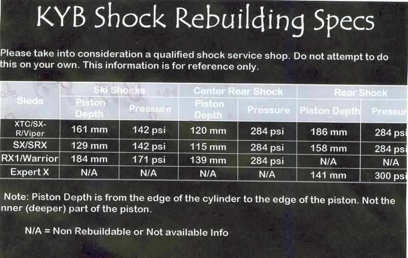

Just rebuilt 05 mono ra shock with 6000 miles nice of yamaha to be so forth coming with rebuild info. Had to use a on the fly shock formula a shock tech in fairbanks walked me tru was very easy now only if we can get some parts from daycore when I rebuild a set of yamaha floats for same sled was pretty easy allso hope some old time shock gurues come forward have a great year riding thirsty for info irondog rtx out
I am in same boat as you.Dealership is first year Yamaha and Yamaha does not give out any shock specs even to dealers.We were refered to the many shock centers out there.They all seem willing to help.Try calling a few of them.I personally have only done the RX1 shocks and floats which FOX will give you specs and support for.This is what I have.I know a Nytro is coming for shock rebuild so will need those specs.
