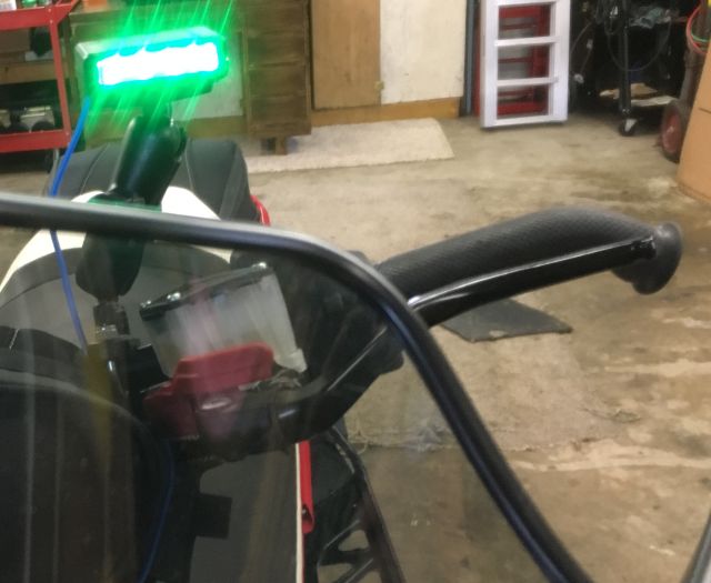

Here is how I mounted mine on the SR Viper, using RAM mount components

I like the idea of not creating any holes for attaching the mount. How is the visibility for oncoming traffic from where it is mounted? Any additional pics to see?

Visibility to oncoming traffic is very good in that position. I don't like putting holes in panels to mount stuff.

Does it reflect off your windshield back at you at night?
That's a good question, I will have to check. Haven't rode with the light at night yet...

Would you happen to know the part numbers for that RAM set up? Did you need to purchase the components individually or is it available as a complete kit?

RAM Mount Part numbers:Would you happen to know the part numbers for that RAM set up? Did you need to purchase the components individually or is it available as a complete kit?
4 inch arm: RAM-B-201U 6 inch arm also available: RAM-B-201-C
Handlebar u-bolt base: RAM-B-231-ZU alternative available such as RAM-B-408-75-1U
Square ball base: RAM-B-347U alternative is diamond ball base RAM-B-238U
I stuck the included Ride Light Velcro onto the ball base
