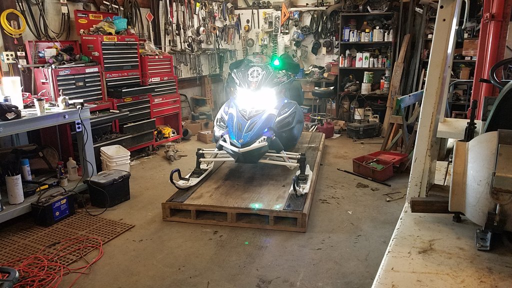

Mounted mine to the handlebars with a homemade bracket. It's up higher towards my chest and my buddy's say they can clearly see it at a distance in the day time.
If I get in the bush deep enough to rip it off, then I'll have bigger problems.
Pic is with my HID's on high beam.
It plugs directly into the factory heated visor plug on the handlebars with an RCA pin that I soldered on.

that looks like a really good spot. it would mount fairly easy off of one of my handgaurd mounts.

I don't have handguards, but the mounts for them should work great! Post pics if you would?
For mine, I split an old 7/8" Polaris handlebar clamp with a bandsaw and used the halves as a base for fastening the light. The light pictured is my older Ride Lite, but would work for Rock's as well.

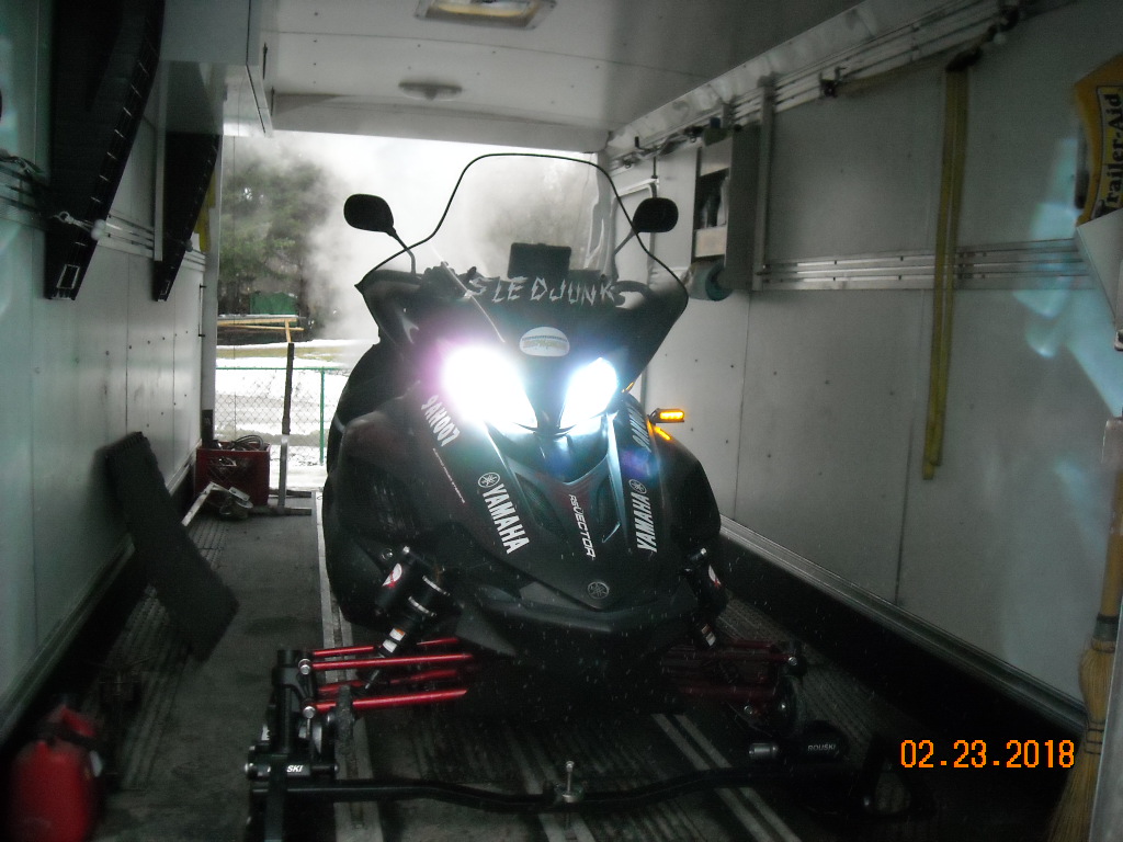

I made an angle bracket that mounts on the side panel through the three holes with plastic 'dart' plugs on the Vector. The light then mounts to a flat plate that attaches to the angle bracket with a single bolt so that it can swing clear if hit by a branch. I have hard wired a cable that is routed through the third hole in the panel to power the light. I will add pictures tomorrow.

As promised, here are some pics of my install.
The bracket and the mounting plate are made of 1/4 inch Lexan.
