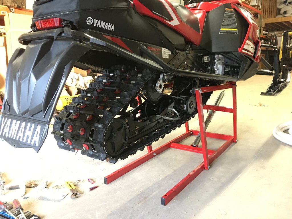

Thanks, all good points,I'm doing it this morning going to get garage toasty warm

That looks like a nice part, is that something you made or did you get them from a shop? If you purchased them how much were they? I just added JTatv 4 wheel kit to mine.I replaced my adjusters with billet aluminum. went right in with out any modification required.

http://www.gripnripracing.com/index.php?id_product=136&controller=productThat looks like a nice part, is that something you made or did you get them from a shop? If you purchased them how much were they? I just added JTatv 4 wheel kit to mine.

This is exactly how my track is as well. Just got it as close as I could and run it

If anyone is wondering, these billet adjusters work well with the Barn of Parts solid axle kit... Travis thought they would fit, and I can confirm. I just finished installing them on my 2017 XTX.
You do have to drill out the hole in the adjuster as you would with the stock adjuster, but these are much beefier than stock. Sturdy axle, 4 wheels, sturdy adjuster.... Bring on the snow!
