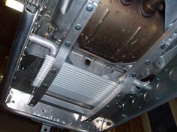

Is your track studded? if so you'll need 1 1/2 inches of protection on these machine made up over the cooler to prevent the studs from ripping open the cooler.
I'm studded with Woody's 1.325 Gold diggers. Got 1000 miles on them. You make protectors out of Aluminum 1 in sq stock from Home Depot. And I added Hyfax over to get the 1 1/2 in. I'm not the only one here that has built them. Some have built them with only 1 in clearance and hit the cooler. This is what we've learned on these machines.
Here a a couple of pictures of protectors made. Again if studded you have to get a total of 1 1/2 in protection over the cooler then taper down to nothing behind the upper wheels.
