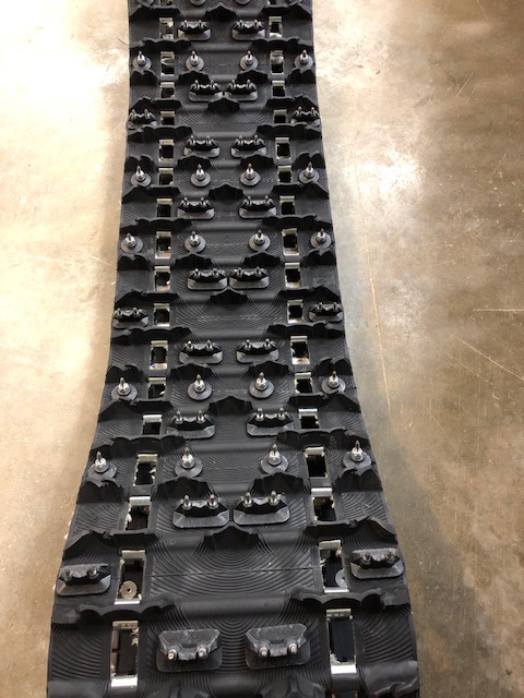

Here is my track now. I have sharpened the megabites but they have worn since new some. I cant keep the front end down with this setup and its just too much traction actually.

Thanks Mike. Is this your own pattern, or do you use a template?If it were me.
Its my own pattern. Kinda overkill though, guess it the drag racer in me yet. I always use my own patterns for best traction and try to minimize cords being cut etc. I also prefer double backers and try to minimize single backers which don't hook as hard and tend to rip out easier.
You don't want the traction lines too close so studs fall into a close grove. Also I build a pattern that does not want to J hook if it does spin. Typical wedge or v-patterns want do do just that.

KnappAttack can you please describe more about what "J hook" is? I'm not familiar with that term (I don't get out much LOL). Why do wedge or v-patterns do it?
Thanks!
Grabbing a handful of throttle and spinning out and hooking left or right. Typical v-patterns promote this because the studs get stuck in the same rut and causes it to washout on the holeshot rather than driving out straight. You know the sleds that have the v-patterns when they take off and look at the scratch lines they leave behind in the ice.

Ok thanks. How about if one moves double backers around so there is as many scratch lines as possible? Make sure they don't follow lines from studs in front of them? Most studding patterns do repeat it's just a question of how many different lines you can get on the ground at once without repeating. Mine probably only repeat every 10 bars and by then the sled has moved ahead enough so none of them are sitting in a line from studs in front of them. Should be good enough for trail riding anyway.

Ask them soon to show you the pattern they intend to use? Want as many scratch lines as possible.
