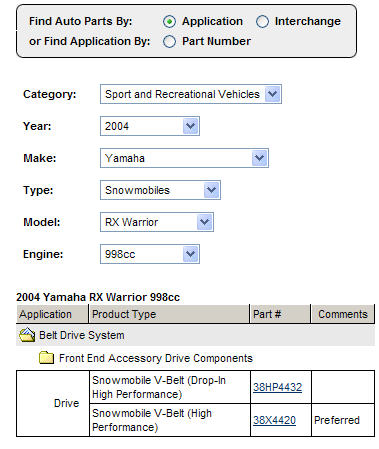

Gates partnumber since LB was too lazy:
Xtreme recreation 38HP4432
Xtreme 38X4420
Xtreme Mountain 38XM4420
Xtreme 38X4420

Him said:Gates partnumber since LB was too lazy:
Xtreme 38X4420
Hhahahha!
Thanks!
Thats what I was talking about, Gates doesn't have one that is the same dimensions as the Yamaha belt.
(The 38HP4432 is a different dimension than the 38X4420 and neither of these are the same as the yamaha belt, yet both are specified for the Yamahas.)
You can step up or down in belt width, and/or up or down in belt length, but you can't get the same width & length dimensions from Gates.
However, I have used Gates in the past with great success.
Looks like Gates just picked a close one to list as a replacement.
That doesn't mean it is the best selection out of the Gates belts.
That is why I asked LB which one he used, wondered if he just followed the listing, or actually measured and/or tried any different ones to see which one would most likely work the best in real life.

Again, go check their website. When you choose RX1, it will tell you the belt to use.
