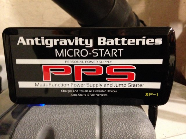

Looking for a new battery. Every time it sits overnight and it is under -10F it will not turnover fast enough to start. As soon as I put a battery boost box on it fires right up. I have 700 miles on now and it gets embarrassing that a new sled has an issue like this. Anyone know of a good brand???
Antigravity makes a battery pack I believe it is the XP1 and I will check for model number and correct if wrong. It will charge at 2 levels 200 and 400 Amps.
Jump starts 3 Snowmobiles
Will recharge your:
Laptop
Cellphone
GPS
Almost anything you can think of and comes with all the adaptorsrequired to do the job. Can recharge with wall charger or car cigarette lighter plug.
The whole kit weighs less than 2 pounds.
I have one and take it when we do club rides or go extended or overnight stays. I've never had to use it yet but for $150 it's cheap insurance. And a dead cellphone is no good for anyone so the ability to recharge a few can be a necessity if traveling where signals are often poor and your phone is searching a lot!
