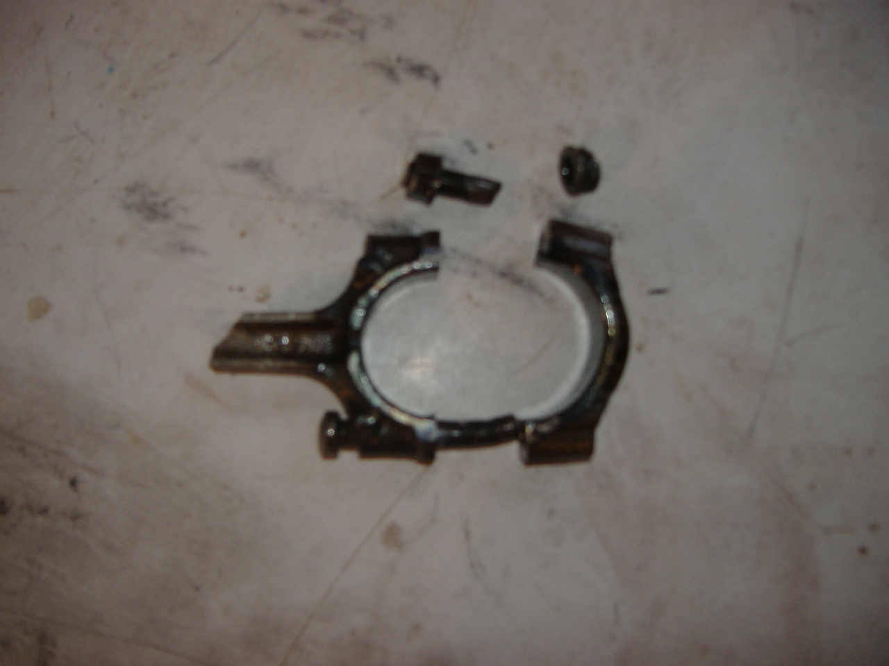

I bought an Boondocker '03 Rx-1 recently and on my second ride it threw the #3 rod out of the case. I was only running 12-14lbs boost with 30% 110 and 6500ft in elevation with 11.5-12 afr's. And its got a .063 headshim in it. The guy I bought it from had bought the sled as a box of parts and had to put the motor together. He put it together and put the turbo on it at 1000 miles and it only has 1800 miles on it now.
I've been doing lots of reading and it sounds like #3 is usually the rod that lets loose on these motors. It was full of oil and only had 250 miles on an oil change with semi synthetic 0w-30 yamalube. It blew at about 1/4 throttle and made no noise or ticking or vibration prior to that. I'm guessing that maybe the rod bearings had gotten switched around when it was reinstalled, but why is it always #3?

I added a pic at the top. The bearing got hot, you can see the bluish color. I have never had the oil light come on on this sled, but who knows about the previous owner.
Looking at this, I would bet the other bearings are shot. Double check, if so then it was an oil issue.
I don't know about the boondocker kit, but my bender had an extension block placed behind the oil filter to feeding the turbo I wonder is something isnt installed correctly? Check for plugged, pinched oil lines. Since the sensor is at the bottom of the oil resevior it will hold oil....no light, but the motor might not have any. Did you have good circulation when you changed the oil? if so then......
if the other bearings are good, and only this one is bad, then faulty assembly or failure in a part caused this.
I remember picking out the same parts out of my '03 prior to the bender....I feel for you!
by the pic one stud is broke with the nut on it and the other stud is in one piece with the nut off, if you inspect the nut are the threads intact or half stripped. I would say py the pic its an improperly torqued rod bolt resulting in catastrophique faillure just my 2 cents
X2 - on what I can tell from the pic
I just looked at the nut and the threads are not stripped. That nut must have backed off. That makes me feel better, I was about to lose some faith in the rx motors.
