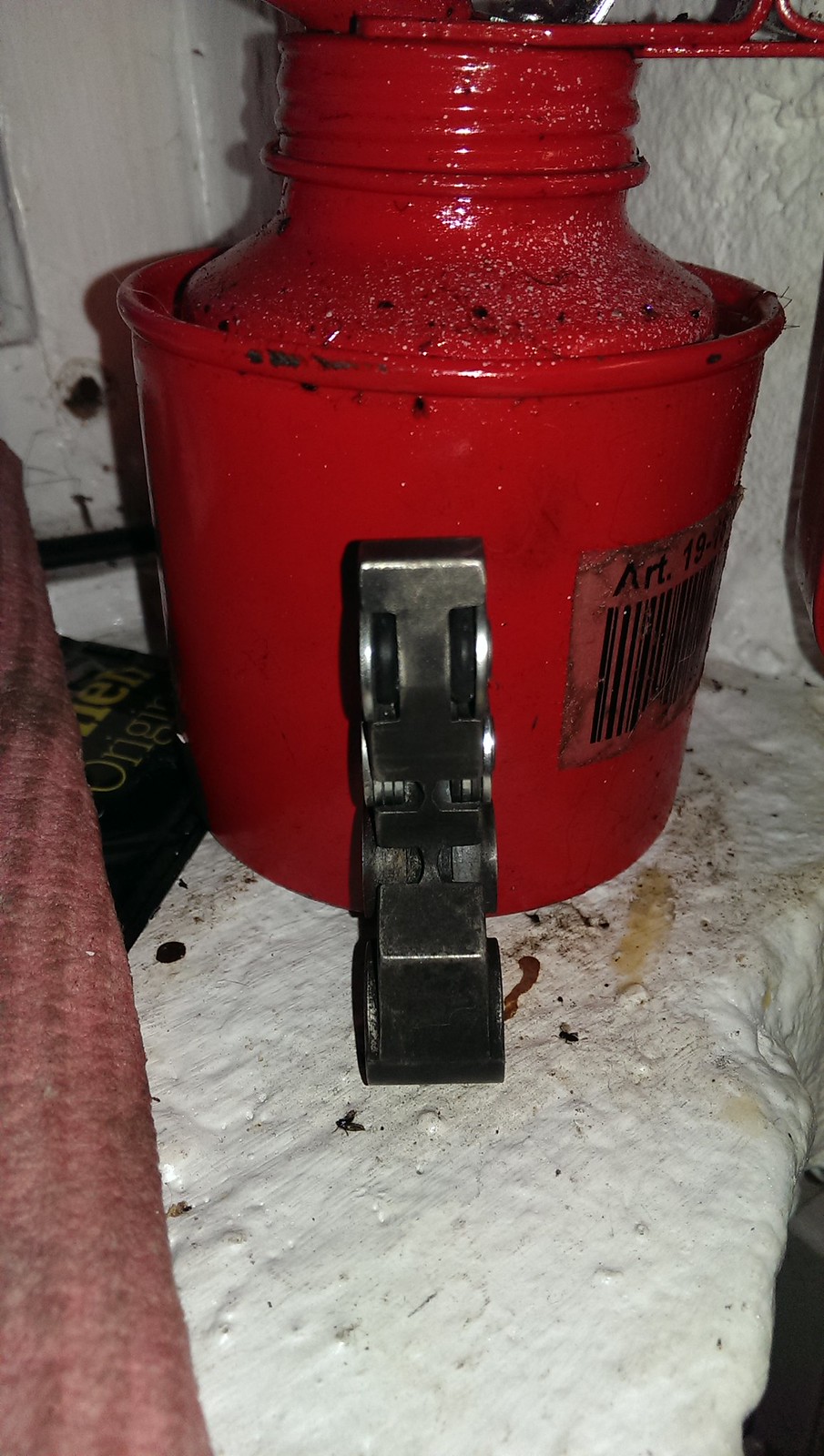

anyways this is what i got i believe im good.

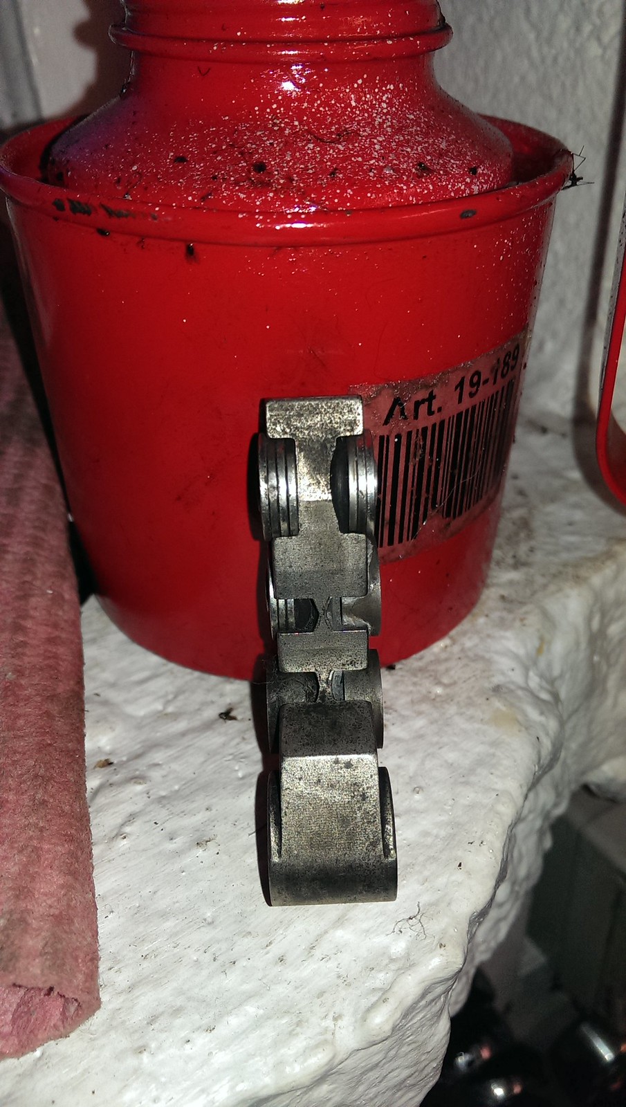

well after a talk and got a better understanding how it works i took of the weights and realized i was wrong with the weight settings:
tungsten,tungsten 3,tungsten 4,3 total 89g
This is what i ended up with due to that i didnt have any more 1gr shims "ordered up"
tungsten,tungsten 4,4 1,1
Now to the point, i removed total 7g and that made the world. the sled is so much more on the go now. But at wot the revlimiter kicks in, then drop to what i can see around 10500, but sometimes even 10000 but can that really be true?
