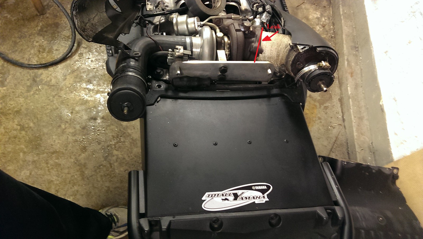

pressure tested the inlet and exhaust.
On the inlet there was no leaks.
On the exhaust i had a leak as you see in the picture, so gonna put in sealent. also a small on at the top of a donut not tighten 100% but not enough to do any to the system, but fixed it.
Even ohm tested the sparkplug coils, all good.
So no leaks at all
Oh yeah also put the spark plugs gap at 0.18 now.
So no leaks at all
