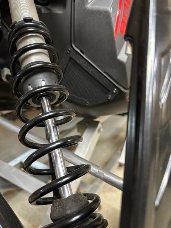

All you need is the front lower moflow vents that are behind the a-arms. I like the ones that go by the knees at well but you get plenty of airflow with just the lower ones and they are stealthy. Dont know they are there unless you are looking for them.Justinator & sideshowbob, I'm a huge fan of the gap ram air. Justin, your pics give it so much merit. It's a thing of beauty.

Do you have any pics, you can share?All you need is the front lower moflow vents that are behind the a-arms. I like the ones that go by the knees at well but you get plenty of airflow with just the lower ones and they are stealthy. Dont know they are there unless you are looking for them.

That's just perfect, justin. I assume you drill the belt guard out? Are you using the rear one as well? Ill have to see how I can get something in blue. I just checked Flo doesn't offer in blue.

Yes I have a precision belly pan protector and I drilled a bunch of holes in it to allow air through the guard along with whatever will flow around it.
