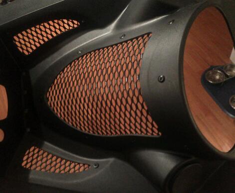

In my write up, forgot to mention the custom dash I did. Was going to go with the Roest vented dash but I wanted to use a windshield bag since I couldn't use a tank bag with my trail tank. The bag would cover up most of the Roest vent, so I made my own, a bit further back.

wow, that looks really nice!
zeke66
That does look pretty sweet. What screen did you use for it?

nice job on the vent!

Hey bird mayon
Where did you get the screen
I would be interested to hear about how you did the whole thing.
Did you make the template
How did you fasten it
Looks great
Ms
Looks great
Ms
Thanks guys. I laid a piece of paper over the top of the dash and roughly traced out what shape I wanted the vents. Cut the paper, then retrimmed repeatedly until I got the size set. I folded the center piece of paper in half to complete the shaping of the template (make sure it is symetric). Once the templates were done, I taped them onto the dash and traced them with permanent marker. Took the templates off, drilled multiple spots just inside the lines as starting points, and used a sharp utility knife to make my cuts. Don't remember, I may have also used a tin snip for part of it. Got my cuts as close as I could, used various files to clean edges and complete the corners. Once everything was pretty smooth, I used 600 or so grit sand paper and wet sanded the edges to get a smooth finish that kept the plastic black (it gets whitish if the plastic isn't smooth enough). I bought a screen guard from Lowes (any home project store), it was just a framed aluminum screen that goes over the bottom half of a screen door to keep feet and knees from breaking through the screen. I laid the templates I'd cut over the screen, and traced out the shapes making the lines ~ 1/2" to 3/4" or so away from the edges of the template, so that the screen piece was larger when set on the inside of the dash. This gives room to secure it with rivets. Once I got the templates cut, checked and rechecked their size, I rolled them into the the same contour that the dash had so they'd fit well. Spraid em with black, let em dry, then laid them in place, drilled holes through the plastic that matched spaces in the screen, and rivited it all together using aluminum rivets and washers on the back side. I reused part of the screen's aluminum fram as a doubler on the backside top of my vent to be sure the screen didn't pull away from the plastic dash when it flexed, but I really don't think that was necessary, just use enough rivets and in the right spots and you should be fine. Then spraid some paint into a cup, and used a Q tip to lightly paint the rivets black so they matched the dash and the vent. That's about it. Took a few hours and seems to work great. I've only run the sled for a few minutes at a time since I installed it but it works, tons of heat pouring out of there!

Birdmayon,
I know this might seem like an obvious question, and I appologize for getting off topic on this post, but i wanted to clarify a few things.
Did you create a border for the screens, or your vents cut in the console that were sanded, ended up being the finished edge. You must have had a steady hand, to cut them that finished?.......
Feel free to show more close up pics of both sides if you could.
Thanks for running through the steps. Again, nice job.
