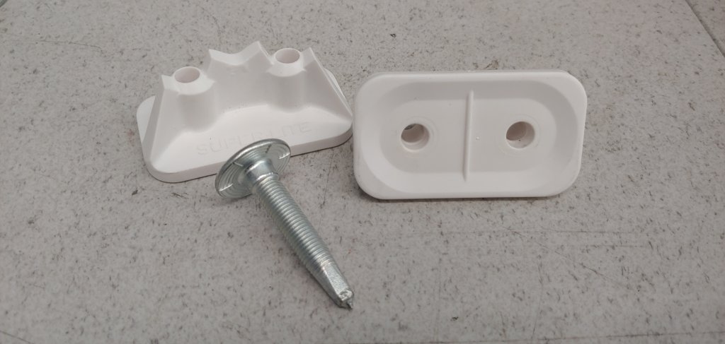

Was there any issue with the shoulder on the Megabite studs keeping them from pulling in far enough? The shoulder is bigger diameter than the hole on the Super Lite Pro backers and is also taller than the recess in the bottom of them.

No issues, just tap them half way thru or slight bit more. Hand tighten for final orientation after tightening with a drill. They will sink into the track and bottom the shoulder like normal when doing this just using soap and water on the whole stud, doesn't even have to be warm water.

I countersunk into the quiet lugs first and shaved them down. Doesn't seem to be any different than normal backers. I can sink them into a std track too. I love the double pro-lites but would never ever use the single ones myself.
I've bent studs and broke tips but have had no failures with the backers themselves, but have overtorqued them sometimes. You'll need spares because once they strip out there garbage. Ive run them for many years and miles on 1200 doos including turbos and now on the boosted winder.

When I first talked to Stud Boy they recommended to tap the backers all the way through for maximum strength as then the stud threads and the backer threads mate exactly and can lock together. Also because I didn't want the stud shoulder to prevent the stud from pulling in and getting as tight as possible, I simply drilled the backer hole in about 1/8" with a drill sized just over the diameter of the stud shoulder (make a drill stop out of a tube that just slips over drill bit to control depth). That way, when I tighten the stud, if necessary, the stud shoulder can go inside the backer a bit to make sure stud is tight and there is good compression on track. Last, for insurance to prevent loosening (IDK if that would be a problem anyway) I put a drop of superglue in the backer threaded holes just before installing stud. Degrease studs prior to install.

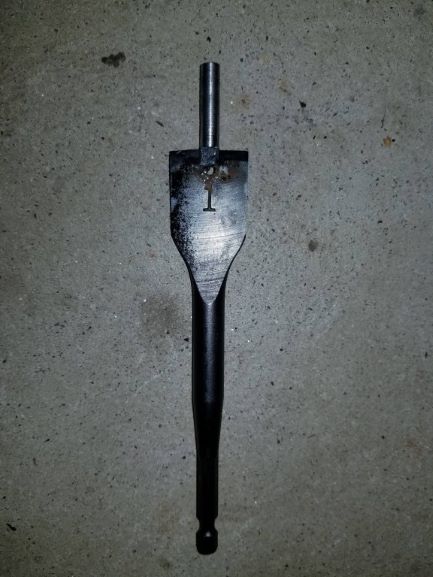

I also removed quiet trak pads to make track flat where studs are. I made a special drill to do this that uses stud hole to align. Need to be careful when doing this so as to not cut too deep.
