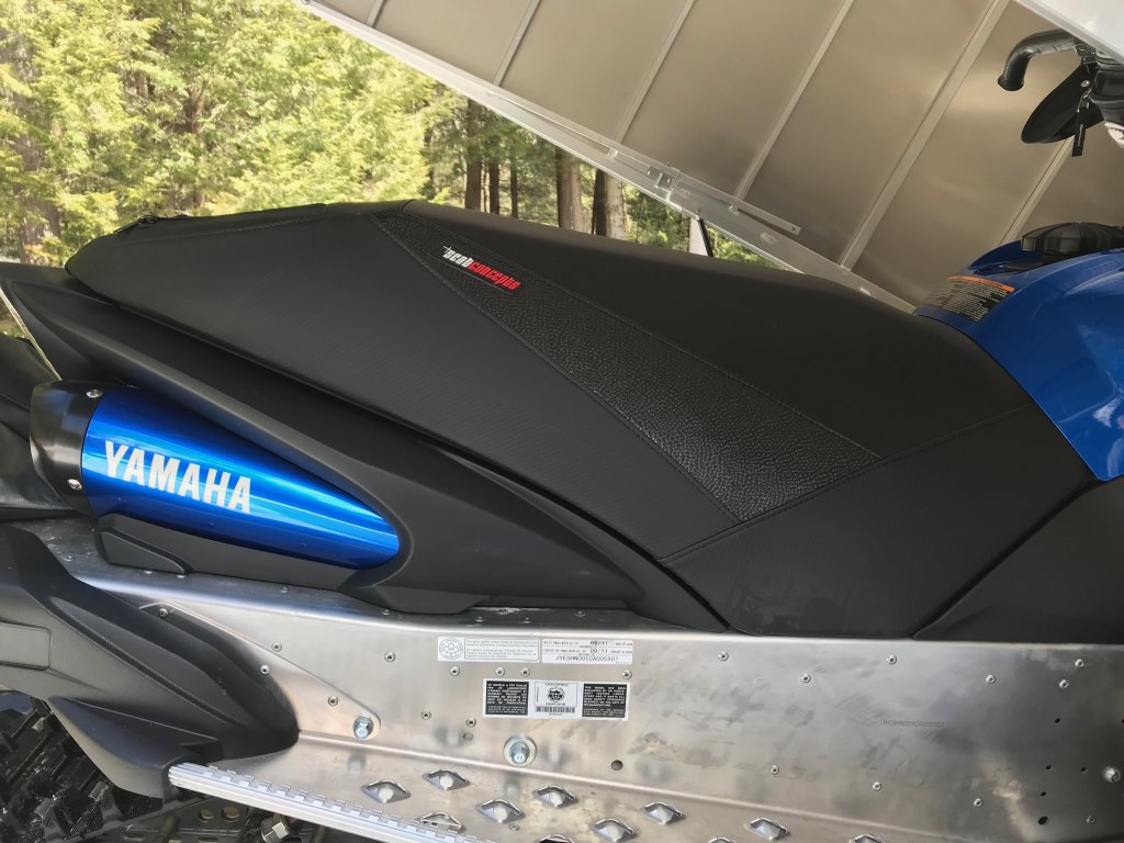

WRP snowmobile seat line has been sold to Seat Concepts. I ordered the new foam and cover from Seat Concepts back in January and now that the season is finally over I got around to having it installed on the stock seat pan. I took it to a local upholsterer who does motorcycle, snowmobile and boat seats. He used stainless steel staples and put it together. Came out fantastic. The stock seat foam is too soft, too low and the stock cover is too slippery allowing the rider to slide toward the bars to0 easily. The new seat foam is 2" taller and has a styrofoam block molded into the foam to maintain firmness while raising the rider up so that his knees are lower than his hips which aids in the transition from sitting to standing. If you look at the stock seats on the new Ski-Doo's, Polaris and Arctic Cat's you'll see they have done the same thing. Yamaha never upgraded their seats to this new design. A big mistake and most assuredly lost customers to the competition. So you have to do it yourself. Contact Seat Concepts and order the kit. Worth every penny. https://seatconcepts.com It's best to call and order the kit over the phone. Their website doesn't have any snowmobile information as they are really oriented toward the motorcycle market.

Looks like a nice job done! Wait till you ride with it on, it's amazing for sure. There is a reason why owners rave about this upgrade. It's a tough nut to swallow as far as cost, but so easily justified once you ride it.
Too bad you have to wait till December to get some seat time on it. Nice work!

I didn't want to lose any seat time by taking it to an upholsterer during the riding season. Turns out, I drop it off on a Friday morning and tell him "no rush" and I get a call on Saturday telling me it's ready to be picked up. Go figure.
