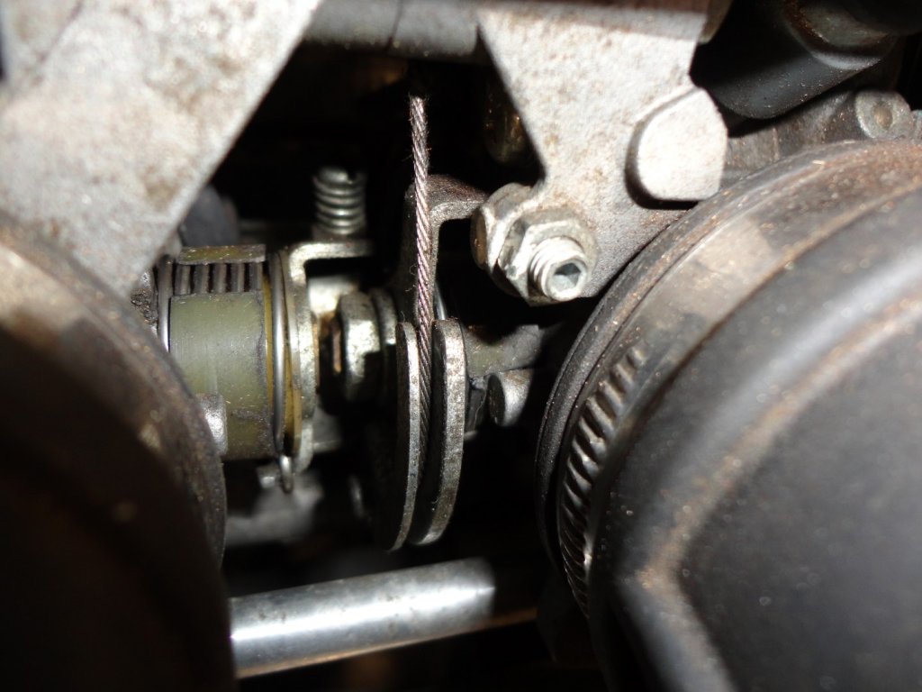

As you can see the tang of spring is not on the nub anymore on mine.

Thanks Cannondale,
I went ahead and moved it past the nub last night. It seems to have went to the back of the throttle body. But, it still has a spring retract and the throttle lever seems to be about 30% easier to move. I think I am really going to like that.
To feel comfortable with it, I cycled it many times. Can not wait to try it out.

Any update on how the throttle worked out?As you can see the tang of spring is not on the nub anymore on mine.
Just installed a finger throttle on my sled. And my arm is buggered after a day of riding lol.
Thinking about trying this. So any update would be appreciated
Thanks.
I ended up putting spring back after having some issues with throttle safety engaging. But shortly after my cable frayed so that may have been cause. Other than that no progress I just got used to it.Any update on how the throttle worked out?
