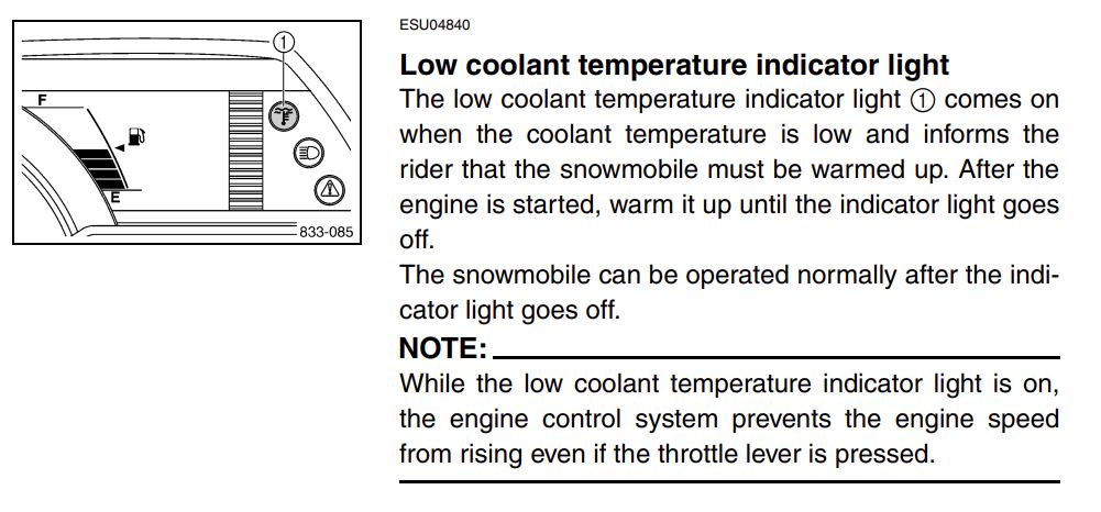

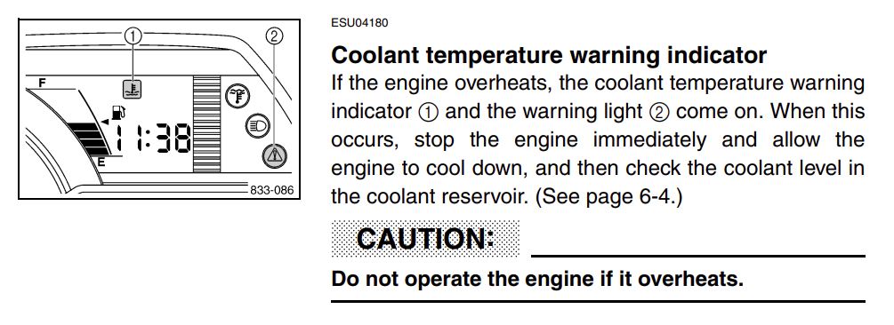

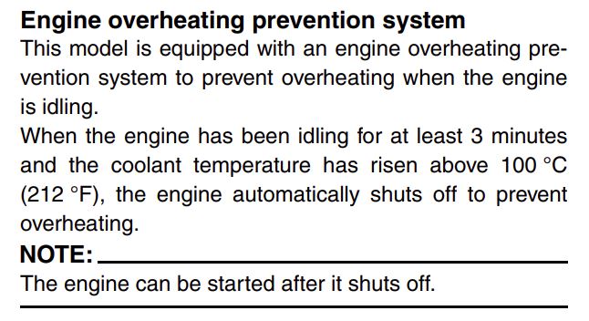

Okay I bled the system twice till I got a good flow of coolant coming out the bleed hole. When I start it now sometimes the red light comes on and then turns off after a bit and it runs like it did before, Itll kill istelf after a while but of course there is no snow to cool it, the fan comes on like before. still no warning lights at that point. Is this normal or......
RobX-1
- 2,582
- 1,746
- Coldwater, OH
On cold starts, it is normal for the red light in conjunction with a flashing temp icon on the dash to flash until the motor warms up. After it has done so, the red light and flashing temp icon will go away:
