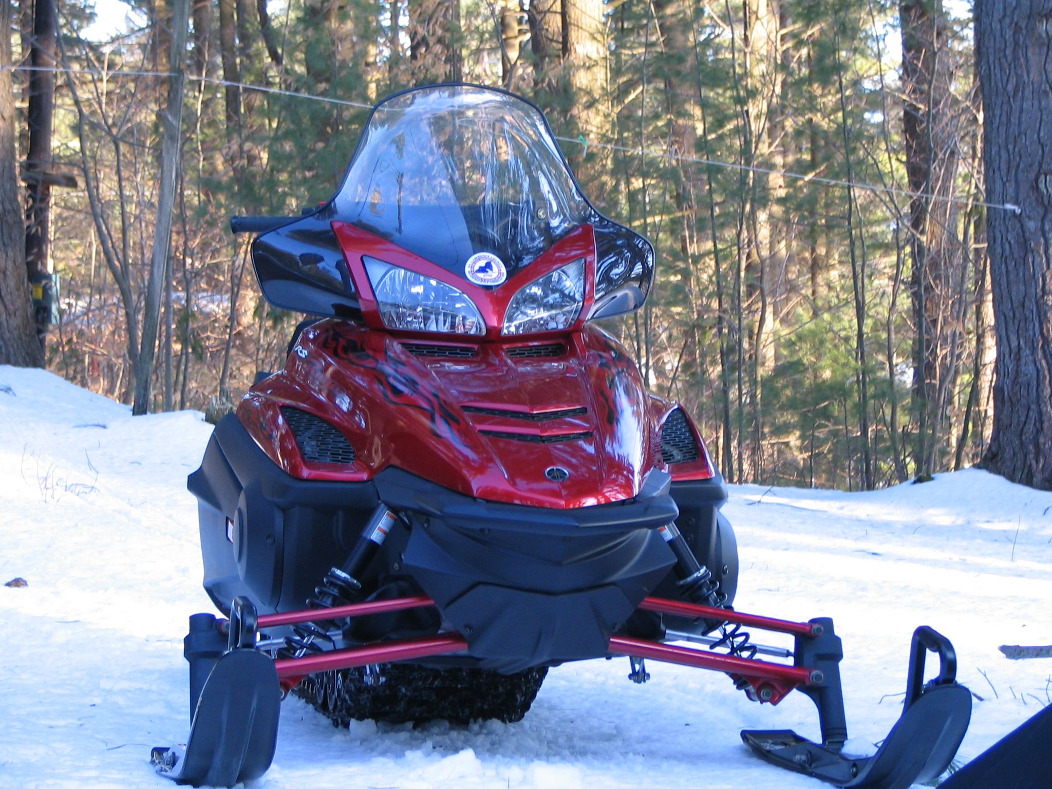

Skid Plate installed. I guess I will let you know If it doesn't work.. Not much winter left so
