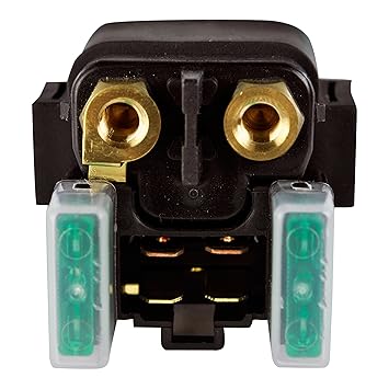

Nope right beside/below the battery. The red cable goes from battery to it.
cloead
- Mar 8, 2013
- 60
that guy?
that's what i replaced when i said "i replaced the starter relay"
not sure if thats the right term for it but it seems to have made cold starting worse

Do you have a manual? I have seen they updated these relays in later models. I ordered some relays last week to replace my old ones and they sent me old ones. I told the owner that there are new solid states out and he said well why did they send me these? I'm like Do I look like Yamaha Canada??? After a few minutes they found a Tech Bulletin (to my surprise) and said I guess we'll order these. I had even told them of this on the original order.. Any way there is a trouble shooting procedure on page 8-12 that will help. You can get a free manual download on this site in the event you don't have one.
