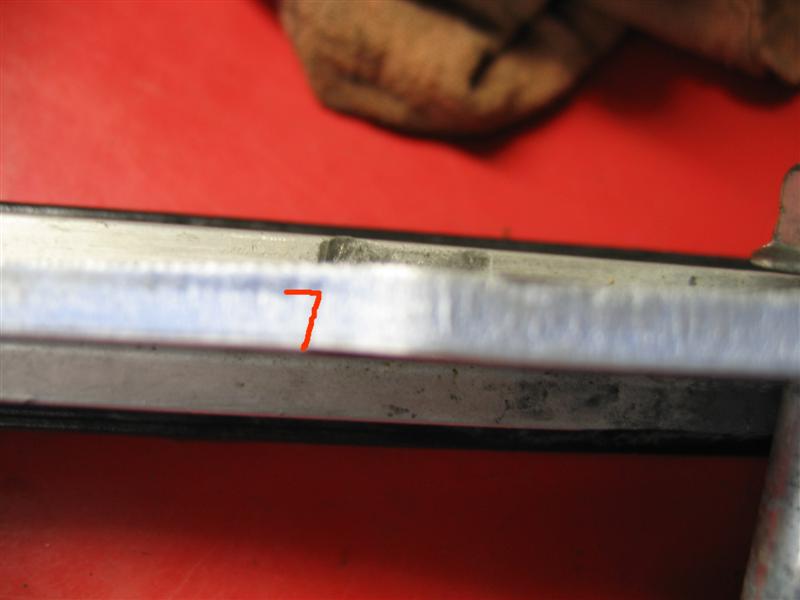

I know the washer placement is going to kill warantee hopes and I will be honest with dealer but in reality looking at how the rail cracked especially on side not broke out it is very clear to me that the washers had nothing to do with that failure.That shaft is bending alot more than that straightedge can show when full force of shocks are on it.Washers which cocked the rails would have caused crack to go on top and bottom of hole not the sides.My camera isnt good enough to show the crack on side thats not broke out but it is exactly how I marked them.We all should get new rails with update kits since bent shaft has weakened the rails.And they still need to figure out how to prevent shaft from bending.Maybe convert all these to the Nytro style if those hold up.

Just got back from dealer.I will admit I wasnt expecting any help.It actually went very well.I brought rails and shaft in and they all agreed damage was from that shaft bending.They will be talking to Yamaha and trying for new rails and a shaft and informing them of my plans for full bushings in that pivot.I think they must have been overwhelmed last time since this has been most riding around here in a decade.Things have calmed down some now.Whole thing went very well.Hope it goes as well with Yamaha.
