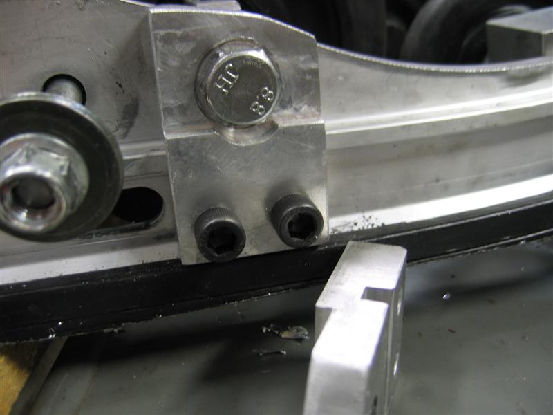

Also made some rail reinforcements.Was a pain since spring would hit bolt if at full width.Plus the spring loop couldn't pivot.Lot of fun milling in a drill press but they turned out pretty good.Nice tight fit.May choose a flatter bolt for bottom two but that shaft wont be pulling these bolts through rail anymore!Will see what else goes now.If snow holds up.

Ended up putting a chamfer on the blocks I made bottom by slides so clips don't hit.Went with shoulder bolts which have shorter head instead of those socketheads.Once again my scissor is almost tight to the front transfer blocks.Good to go!Dang I hate putting that suspension in.Really missed riding the Phazer last weekend.Few ditch/river runs then Either finding snow up north or going to Lake Geneva for that riding they have for us Phazer and Nytro guys.Anyone else going?
