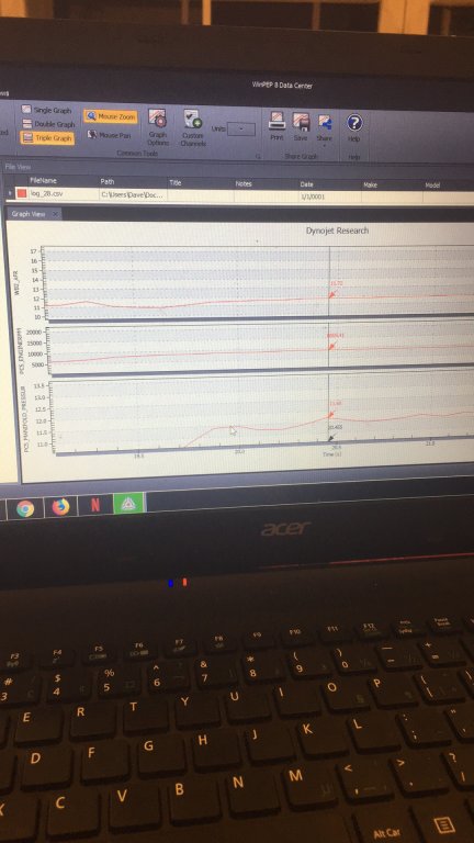

Blownhard
- Mar 20, 2017
- 48
- 708
- Niagara Falls
- Nytro xtx
Sidewinder ltx-le
Check your TPSHere is a data log. At wot it runs perfect.

It’s good checked in diagnostics goes from 16-96 steady when throttle appliedCheck your TPS
