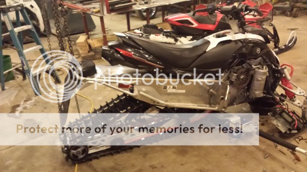

Tracks USA tip up rail. Extra wheel kit right a stock location, 144x1-1/2. Cutting bumper off and doing my own custom extension Sunday?
The chain case was simple. Took my son and I to get the front two bolts out of the skid.
Cut a 15 inch track down to 14. Can be done, did it with a saws all but not the cleanest job.
I was able to climb the drift twice no issues, dead start and climb. This thing is a blast, can't wait to boondock with my son.
Pictures added.

I have some 1" diameter round tube. I am cutting the bumper right after the "y" and extending it 12". As for tunnel, I will just bend some aluminum plate.
Nice to own a fab shop, it's time I am having a problem with lately.

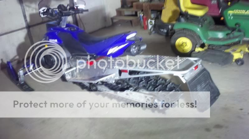

Here is how I did mine used the stock mtx bumper then got a sheet of aluminum diamond plate cut it to size and used a brake on the edges, it extends all the way up to the front of the seat in the '07 there is a rear hole under the muffler that I covered also.
Nice job.nswsparky said:Yea my new track was super tight with the extensions. I ground more out of the adjusters to get it looser and ran the lock nuts backwards and only have a couple threads engaged but it did stretch a bit now after a couple years. I am running 9 tooth anti ratchet drives with the rail tips cut off and anti stab wheels on it.
