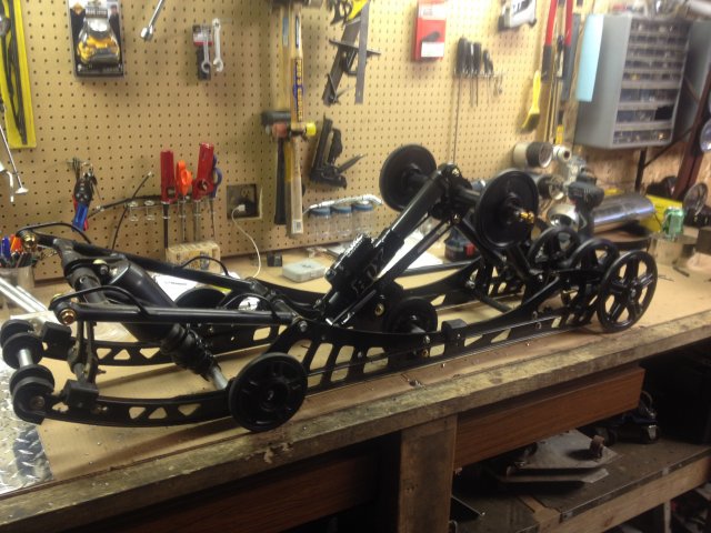

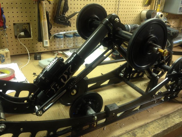

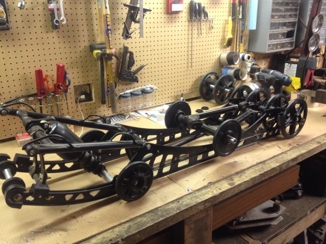

I had this idea to make a 137 XTX uncoupled Hygear Fox Float Suspension for my LTX... here it is all set up with XTX Arms and LTX Rails. I took the Arms off a MTN Skid... these are the same as the XTX.

That is going to be sweet nice project!
It is! Can't wait to see how it works. I liked the 137" but hated how it always felt heavy in front end transfer wise. This one should easily be able to wheelie over the big holes and moguls.

Thats what I was hoping for... more of the XTX feel and handling.

Curious to hear how this works. I hate how my ltx is too planted in the front. I don't like a wheelie machine but it's nice to be able to lift the front when you need to

I dont think the XTX is a wheelie machine at all... I prefer the more planted feel and the ability to carry the skis..

Are the shocks a direct swap from the ltx to the XTX arms?

I think some of the transfer problem in the LTX stems from the shock valving. Once revalved properly, mine actually weight transfers much better.It is! Can't wait to see how it works. I liked the 137" but hated how it always felt heavy in front end transfer wise. This one should easily be able to wheelie over the big holes and moguls.
Regardless, uncoupling might be the best of both worlds. Might be on to something with this Tom.

Tom you might want to put a 160 pound spring on that skid shock. XTX and MTX come with 110 pound and other Vipers come with 135 pound, contributes to heavy front feel.

I did not measure the diff in shock length. I will have to check that out. I used the shock from another skid I was removing part from.Are the shocks a direct swap from the ltx to the XTX arms?

I have an XTX with that same setup and love it... I have no problem with the center spring on the skid when the rest is set up correctly.

You probably already checked the center to center dimensions between the arm mounting holes on the rails to make sure they match the XTX, but thought I'd mention it. If the LTX hole spacing is different, you may encounter some geometry problems.

The front skid shocks are different length between the XTX and LTX. Check out page 8 in the 2014 service manual. looking at the dimensions I would try the LTX shock first because it has a shorter collapsed length and make sure it hits the rail bumpers slightly before it fully collapses.
