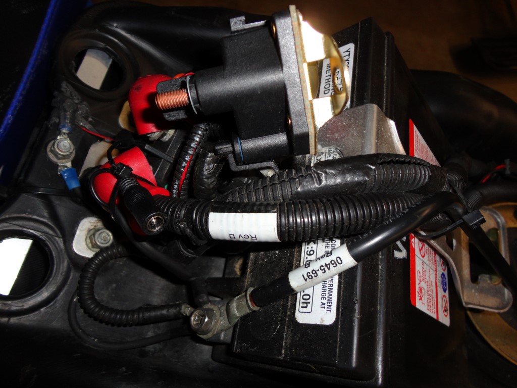

Cannondale27, do you have to replace starter when you do this solenoid?They will be able to look for chipped teeth at least on gear when starter is out. OneWay would require some work to get at. Usually one way either works or it doesnt so probably will be fine. Failure actually has nothing to do with the engine running. If key were still in on position it would do same thing. Basicly starter is just spinning freely but for way too long. It gets hot and then the magnets fall off because glue holding them on cant take the heat from it running so long. Its almost always caused by the Solenoid(relay) at battery sticking on. For 18 they updated the Solenoid. I havent gotten around to putting it on but it should be a pretty easy retrofit. REPLACE SOLENOID AND STARTER AT SAME TIME.Here is pic of the 18 Soleniod. According to tech manual it is more reliable than previous version. I just plugged it in and turned key and contrary to rumors it is NOT solid state but I do plan on installing it to prevent a failure such as yours.
View attachment 135776 View attachment 135777 View attachment 135778
No but if starter ever fails such as O.P. I highly advise replacing both.Cannondale27, do you have to replace starter when you do this solenoid?
That gear should spin freely one way and not the other. Check it again. Also don’t forget to replace the Solenoid I have pictured above. That’s what caused this issue.Hey Cannondale,
Are you recommending replacing the starter when you replace this solenoid? Are starters the same between 15 and 18?
I looked up the part number for the arctic cats in case anyone cares. 2015 number is 0445-123, $11.95 and the 2018 number it’s 0445-121, $19.95 at Country cat.
No. IF STARTER FAILS I RECOMMEND STARTER AND SOLENOID REPLACEMENT.Are you recommending replacing the starter when you replace this solenoid? Are starters the same between 15 and 18?
I am replacing my solenoid just as a precaution.
