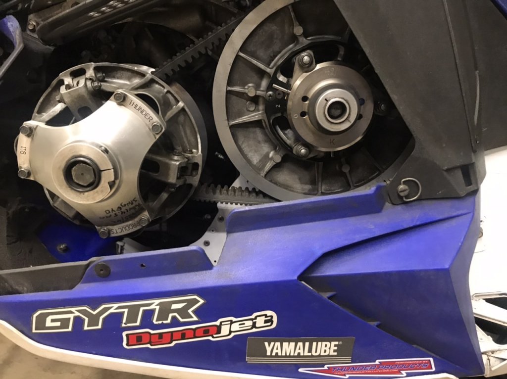

Wow! One day delivery from MI! THANK YOU TERRY AND TIM at Thunder! Can’t wait.
Great weigths! Glad you back on track! Thumbs up from me and my wife in Scandinavia!
UPS ExpressWas it SpeeDee ?
All set! Thunder saved the weekend.
