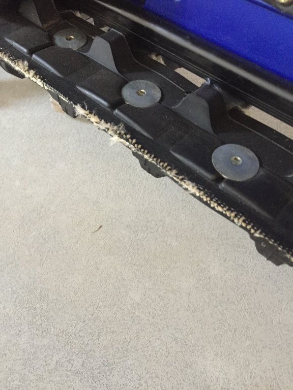

View attachment 129184 This is where the driver alignment, 14 wide track idea comes from. I'm always chasing the track alignment around. It's a pain to get it centered in the back and after a ride it seems to always favor this side. It's been like this from day 1 so it's not bent from riding it or anything. Just thinking at high speed if things aren't perfect it's easy to lose mph. It could even be a junk track from factory? Am I crazy for wanting to change drivers and track??
Personally, I wouldn't be changing the drivers. And if I were you, I'd bring it to the dealer and have them go through it with a fine tooth comb! I don't think putting a new narrower track and new drivers is going to solve your top end problem (but I'm no mechanic either).
And it should DEFINITELY not be struggling after hitting 100 mph!! Not with the power that this sled produces, and the new improved clutching to go along with that power should be rocketing you past 100 mph like nothing you've ever rode before... that isn't having too high expectations either.
Bring it in and have it gone through.

Whenever I've struggled to align the track properly regardless of brand I discovered drive sprockets misaligned. Will pay close attention to the new one when it comes in. 4th wheel kit as well.
I struggled with track alignment from day 1 also. Resorted to just doing both bolts even and riding. 10000 mi later track delaminates so replaced with same Rip2 but also put introvert drivers on. According to my measurements old set and new we're within .030 in of each other at the hubs. Now my track can very easily be aligned. Goes right where wanted and 1/8 turn makes it move over noticeably. So although not positive in my case the track was the culprit. I agree with these guys though. For top end the name of game is POWER. More is better. Gearing,tracks,clutching etc all adds up but nothing like a big power boost.
Lol..if you got 10,000 mikes out of a track...you have done REAL REAL WELL!!! But perhaps cwcsrx700 does have a bum track on his Winder as well. But even if that's the case...that Winder should still be blasting past the Century Mark like a raped ape regardless imo.
Yup for sure. That's why I bought same track. He has two issues. I just posted my experience to point out that my track and driver change did not really gain Any more than a few mph even though alignment was fixed and drag was greatly reduced.Lol..if you got 10,000 mikes out of a track...you have done REAL REAL WELL!!! But perhaps cwcsrx700 does have a bum track on his Winder as well. But even if that's the case...that Winder should still be blasting past the Century Mark like a raped ape regardless imo.

It just looks like the drivers need to go towards chaincase 1/16 or so, and if I tear into it that far parts are getting changed out. I,ve never seen such a rubbed up side of track before, I melted the strings on the edge several times so it doesnt look so bad. I know the sled is making the power, good rpms and its a rocket to 100
so Im gonna try things in this order with the drive train. Track, new or realign drivers, suspension and chain case inspection, clutches. I will get into the hoses and clamps to double check things of course beforehand per Mike Knapp. I have a super low miles apex primary to try also. Heck I'll put a button secondary on it and clutch it like my turbo nytro was to see if that helps?
