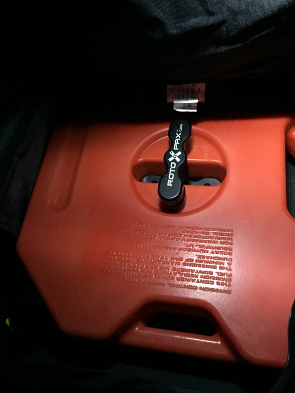

What size can is that?View attachment 134825 View attachment 134826 I used Rotax mount with pop rivets. Just drill the holes through the bag.
Do you think you could still fit a back pack inside the tunnel bag?
What mount did you use? Sidewinder has the heat exchanger under there so you cant drill in the middle.
I was thinking one of these would be needed.
