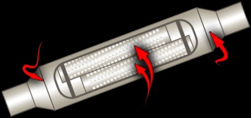

Here is a picture of the exhaust setup out getting welded up. It is a 1.75 inlet/outlet flopro bafflepack. Im hoping the baffle chambers will keep this a bit quieter than the straight through glass packs. Ther will be a turndown welded on the end at a 45ish degree angle pointed to the bottom edge of the tunnel.
