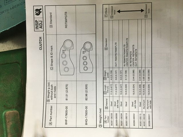

So took the time and cleaned up the clutch today, it was a little dirty but nothing bad. Checked the sheave faces for wear abd they look good. The movable part of the primary seamed to slide Easy. Rode it around the yard with cover off for about a minute and the primary sheave inside clutch was too to touch.
How do I get more clamping pressure out of the primary? Thanks in advance

drill the head off and pop them out with a punch.

I guess I didn’t explain what I was looking for. River removal will decrease clamping force?drill the head off and pop them out with a punch.
