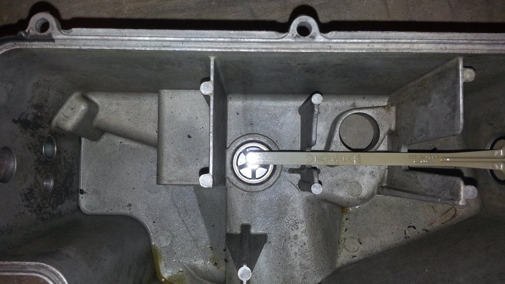

Someone simply ordered a dipstick and put it in the old style sight glass tank. The dipsticks were designed to be used with the MTX tanks that had a baffle inside to help keep the oil at the bottom of the tank during extreme angles. If you had a sight glass with no baffle on a trail sled you would use 4.1 quarts of oil and if you had the dipstick with the baffled tank you would use 4.4 quarts. These oil volumes are assuming you've changed the filter and drained the crankcase. Since you don't have the baffle inside of the tank I would probably run at the sight glass level to help keep oil out of your air oil separator.

Here's what a dip stick in a sight glass tank looks like..
