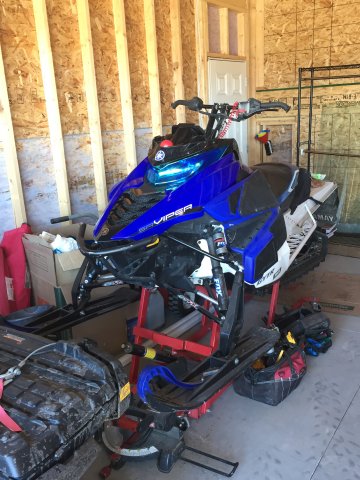

so I picked this viper up end of last year it's a 2014 viper mtx turbo has 1000 Kms on it I'm about to do my first oils change looking for any tips and tricks also why do they not have a dipstick!! I know there is a thread about this but just looking for direct tips and how do I know about my oil level through the sight glass on the side?
