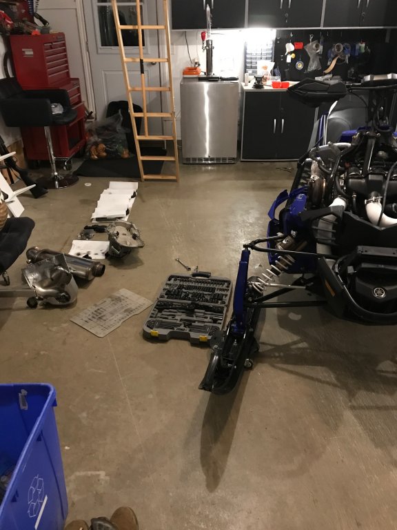

After you get the gear case off, take a picture of everything assembled and steps pulling the gears out. By the time you put it back together there's a good chance you won't remember or will second guess how it goes back together.

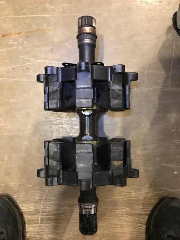

Inspection of the gears and chain was great after 2700 miles. No sign of wear even on the main top gear.
After the chain case was gutted I pulled the skid out. I didn't have a ceiling winch or high jack to lift the back end way up. To get the skid out I used a ratchet strap to pull the front shock down to pull it out easier. Taking the shock out would be an option but just another bolt to remove.
When the skid was out I went to the clutch side and oops....I forgot to take the secondary off before I took the gears out. Not a bid deal but you have to jam something in the secondary to get the bolt off. Brake doesn't work when gears are out. lol

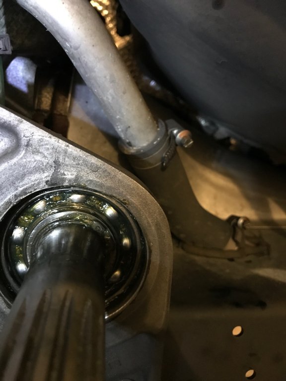

After that was out I inspected the bearings on the top and bottom shaft on the clutch side. The bottom shaft bearing was good but with little grease left in it. Cleaned the junk out with a Q tip, sprayed with wd40 and packed it with grease
Cleaned packed with grease:
The upper shaft bearing on the clutch side was pretty much empty with grease. This should b greased more regularly.
Packed with grease:

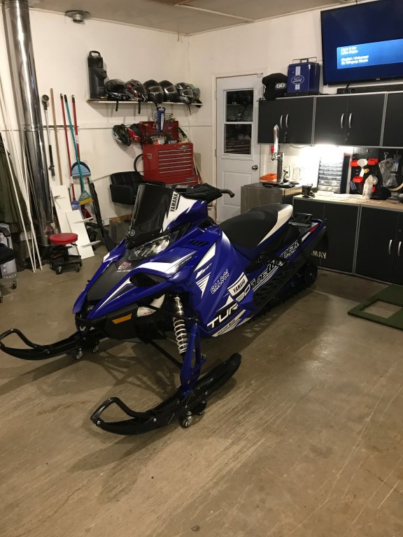

All in all it went well with help from this site and Cannondale. The reverse works and no leaks so far!

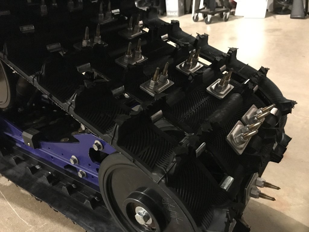

I love the studding job! This is the way I always do it with double backers. I don't understand why so many guys swear by double backers and then put singles in also?
4-2-4 pattern rocks and is all doubles!!!

Which brand and type of chaincase oil are you using ? your top gear bushing looks to be in great shape.

He told me Yamaha Chaincase oil.Nice write up...
For me, I like double backers, but only when used on a row of at least 4 studs. I am not a big fan of ONE double backer on its own in a block. I dont like the imbalance of it, and it must be offset so it does not hit middle protector.
Most guys who run 2/4/2/4 pattern will run 2 doubles(4 in one block) then two singles, so they can be spread evenly.
What I would do if I were him, is add one more double per row, so he ends up with 4 per bar. It will be much more evenly spread then.

Its just the Yamaha gear oil I have already added the extra studs. Didn't like the look of the missing link every other bar!

I am not a fan of double backers, too much load on the track. If you get a tear out you need to swap tracks immediately.

I know alot of guys who agree, and do NOT like doubles at all. I have always only run single rounds, and do like the way you can adjust your pattern so easily. But this yr Im trying doubles(every other) and singles for the 2/4/2/4 pattern, which does work nicely. I just like them to be more even, so only using doubles in 2's(4 per bar) and then singles in 2's(2 per bar).I am not a fan of double backers, too much load on the track. If you get a tear out you need to swap tracks immediately.
