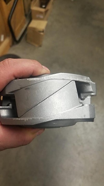

Nice work Terry......So it looks like the surface is machined, but still a cast helix? Hard to tell from Pic. But is that even possible if its cast still?
Now having a straight 37 would make better sense to me if the SRX does come with that. The 35/39 reverse angle with pink(apex) spring just seems like a bad combo.
Dan
Yes, cast helix, but machined on the ramps and where the helix bolts on. Still cast where the hub butts up against the washer holding on the secondary. Would that be enough to tilt the helix away from the rollers? I'm thinking possibility.
What about the belt? Are people checking this with belt on?
I'm guessing so. The ones that I have seen thus far.
Should have belt off. It can easily effect the roller contact since is always some play in bushings.I'm guessing so. The ones that I have seen thus far.

Yes, 35/39 is what our spec sheet says.
helix is measured against a 17-18 and is a straight 37 ...
I don’t have one here to compare. Can only go off what were told, seems there has been a couple posts about this with conflicting info. Stamped with one number, measures like another... Pictures are worth a thousand words.

heres a 2019 against a 37 degree sidewinder helix

lol thank goodness for the experts...because my old naked eye didnt see that..
haha...myeyes are old too Steve. with the rounded edges on the casting you probably wouldnt notice much, plus the ones that are just raw cast usually have a bit of a twisted inconsistent ramp anyway

heres a 2019 against a 37 degree sidewinder helix View attachment 143292
And there you have it....A picture is worth a thousand words
