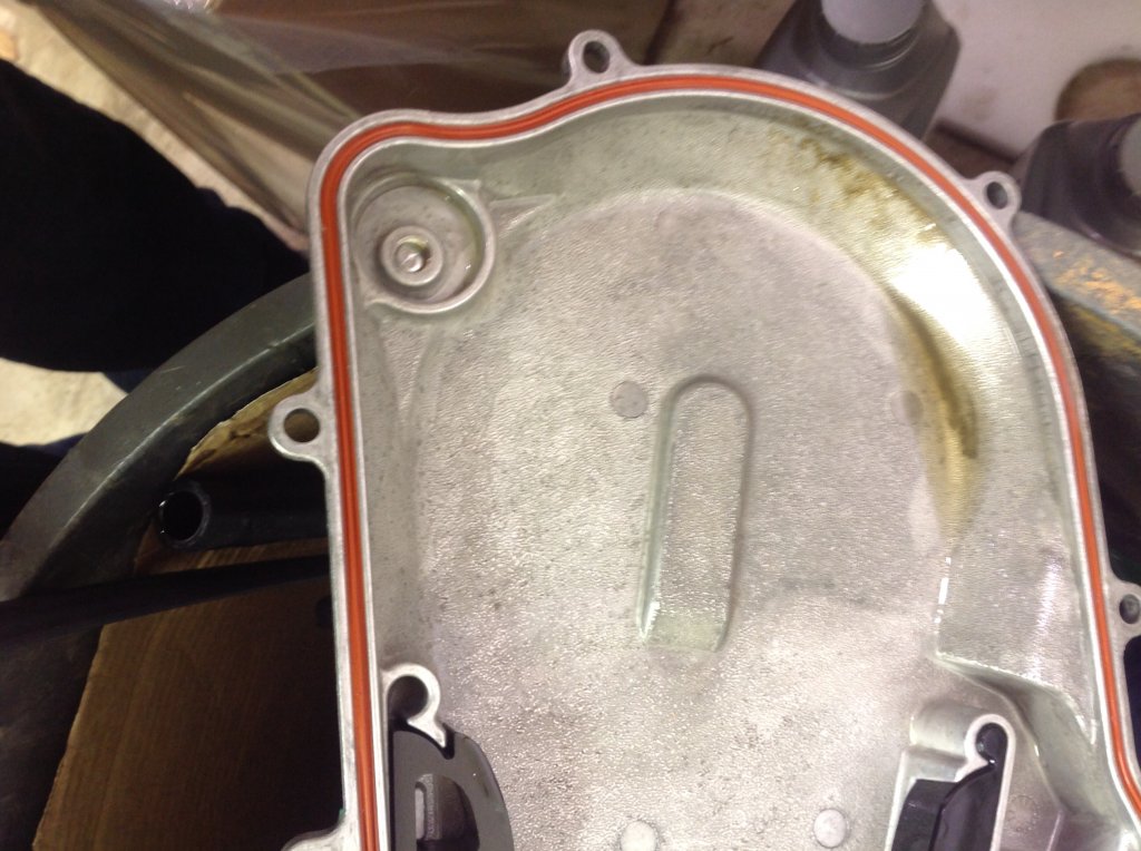

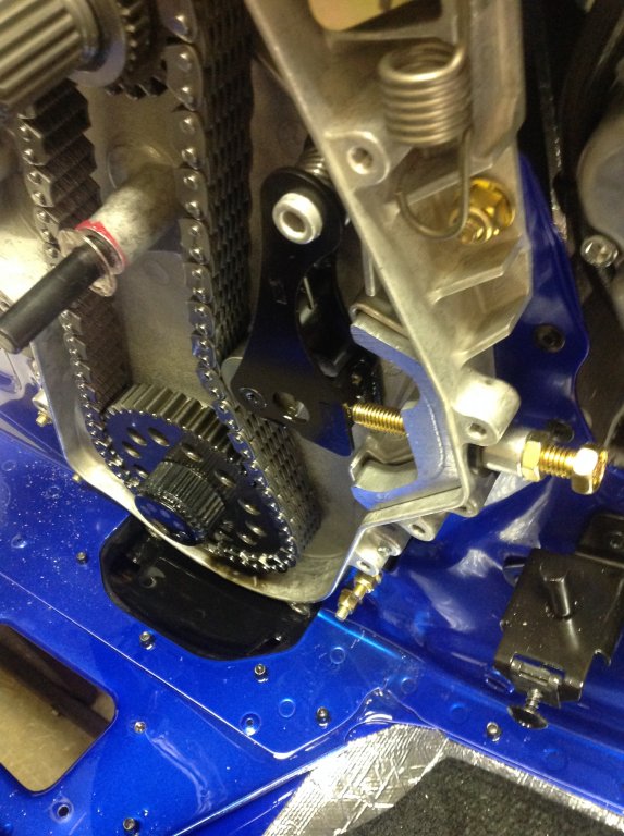

Gosh, it is almost hard to believe that they haven't changed the roller/screw configuration after all these years. Although I did have my sight glass fall in on my 18, I am of the opinion it wasn't as big as issue as the top gear bushing life, or the roller screws backing out. Still good to see that changed none the less.View attachment 156774 View attachment 156775 View attachment 156776 Just a heads up anyone with a new sidewinder, you might want to check your sleds chain tension. I took mine apart last night to go through the chain case , it came set up tight . Bolt was tight against the tensioner ( no gap ) , with spring fully loaded . Chain had had every little play in it . Backing mine off 1 & half turns , then check tension after 300 km .

I took delivery of my 21 SIDEWINDER LTX-GT on Oct.9. I will be checking chain tensioner as part of my inspection before running my new sled. Thanks for the good info.

Great advice for Winders AND Vipers. I haven't checked mine yet, but was already planning on it before it hits the snow. This exact issue cost me a chain case and a weekend of riding when the '18 was new...

DuPont sliders, Installed bronze bushing top gear , spot weld chain roller screws , new NTN bearing in brake caliber, peened 4 sides on driveshaft bearing surface with some lock tight , and a new lightweight brake rotor for sum extra bling for me to look at ...lol
Drive sys should be good for the winter.

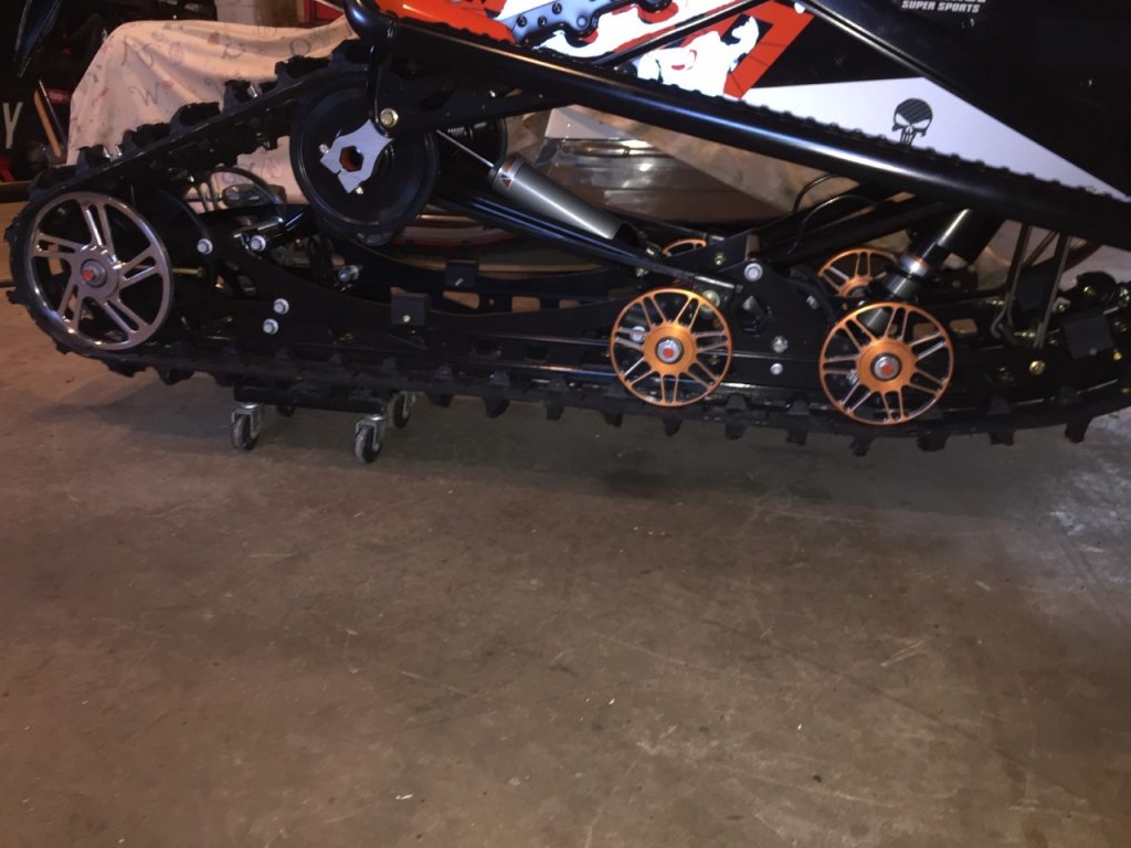

Its funny but I searched sidewinder issues found and i might as well sell mine for scrap..Because there is something wrong with everything...everyone's an engineer these days..all in all I have not had but one issue...these sleds hand down rock!!!!

wow..that is nice!!!2021 BlingView attachment 157402
