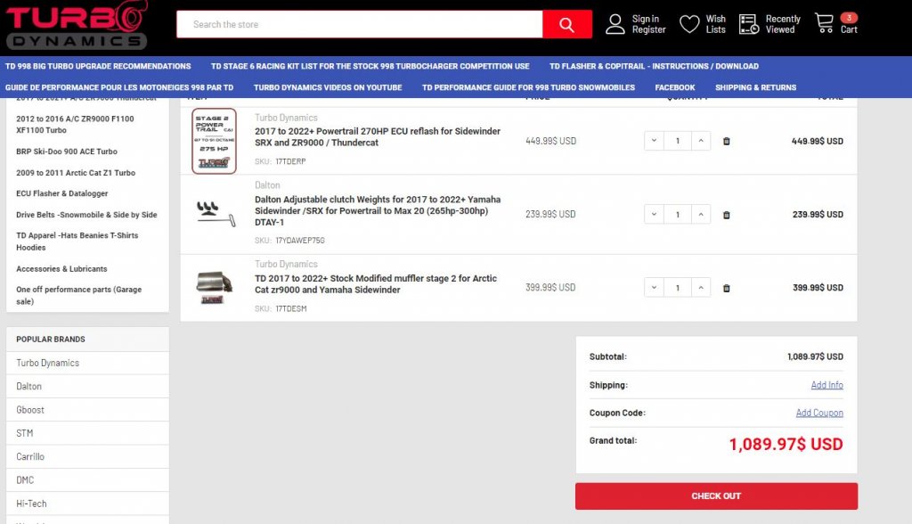

your numbers are way off!!
below is a screenshot, $1100 all in for 270HP

Still need bov and map upgrades

Header, intercooler, hIgh volume fuel pump, billet clutch,, intake, more studs.....

you dont need map upgrades for every tune. Hurricane has 240R,270R and 290 which utilize your stock map sensor. Ecotrail and powertrail and max17(not maxspool17) can be run with stock map sensor. Superspool hurricane tunes require 3 or 4 bar sensor as well as maxspool series of tunes from TD. Blowoff valve is a good upgrade but not required on 240 tune or ecotrail and powertrail tunes. Some leak early from factory and some dont, only way to confirm is with boost test but either way your only adding $150 to the above totalsStill need bov and map upgrades

Nope!!!Still need bov and map upgrades
