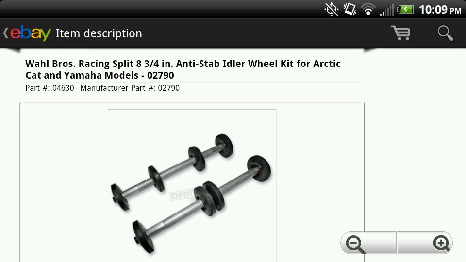

Probably nothing. I just had them make the rod with two wheels on the inside, then two wheels on the outside of the rails. I think that is a anti stab kit. Make sure the wheels are 3 1/4 inches. 2 3/4 is to small. Make sure the bolt is long enough to go through the spacer from the outside the rail. And into the center rod. I think my bolt was like four inches or something like that. It's a pretty good set up. I just couldn't see another place to put wheels. I have around 300 miles on with those wheels and everything looks to be working out good! Straps never move and the hyfax has not worn down since I put them in.

wheels
Ok th
anks just checking, thought maybe they stole your patten.
Ok th
anks just checking, thought maybe they stole your patten.Is this a complete shaft replacement or just wheels that bolt into the existing shaft?
- Apr 17, 2003
- 5,567
- 1,484
- 2,003
- Menno, SD
- www.ulmerracing.com
- Menno, SD
STENOD said:Is this a complete shaft replacement or just wheels that bolt into the existing shaft?
Wheels that bolt into existing shaft.
