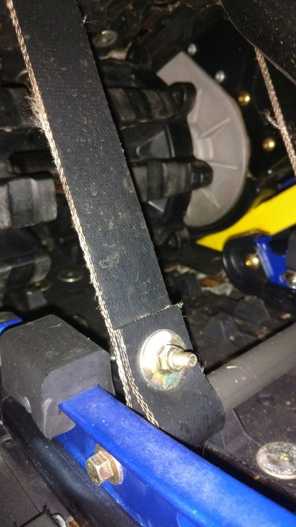

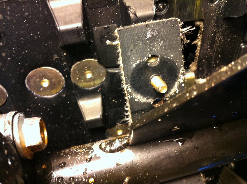

Stupid question time......
How do you adjust limiter strap without any adj. Holes? None at top either. What gives?

The holes are not obvious at first glance. They are there. I let mine out to the farthest position. My sled came from the factory set at 1 hole shorter than longest.
I chose this as the starting point because I am running Trackers on my 6.9’s

I felt over the top. I will check it out tomorrow. Transfer block was on the thinnest spot or #1.

Remove the bolts and reveal the holes covered by the washers.

Right on...... Thanks

pics....stock is second last hole but is covered until you remove bolt.
137 still has poor transfer no matter what I tried.
