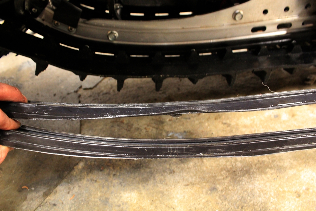

I think my new track was adjusted WAY too tight . I should have checked it but I expected the dealer to get it right. No way in hell these slides should be worn out like this so fast. I have the Wheel Kit on order from Ulmer and left the track much looser this time around. I also went with the HP hyfax. If it doesn't skip then i'll adjust it back until it does ,, then 1 turn forward lol .
220Km's with 4" of snow over hard packed ungroomed trails.

i have never ever seen sliders that melted, wow.
^^ I know ,,, my other sled that has a 1.5 136" track and gets well over 2500miles per set . I think the track tension had a lot to do with this excessive wear.
My dealer wants the worn slides back to make a case to Yamaha. I'm pretty sure he won't get much of a response. I do applaude his efforts and I am grateful he is willing to try. Fact is ,,I'm out 45 bucks today and 1/2hr of my time to replace a set of slides that should not be worn out

I have 600 miles on mine & not even close to that bad. If your wearing near the front bend track is usually too tight for trail riding.
Turk said:I have 600 miles on mine & not even close to that bad. If your wearing near the front bend track is usually too tight for trail riding.
Turk , how much effort should it take to push the track off the front contact point at the bend ? I'm curious as mine was adjusted so tight it took a lot of effort,,too much imo. Yamaha track tension spec seems too tight if that's what is was set to . I adjusted my limiter up 1 notch after the first 100km's. Looks like I should have taken some track tension off as well ..

I took them out with the Susp in the sled. Take out screws, a few taps to get them moving , a few choice words used to get the ends through the windows, then a slide hammer with Vise grips to slip them off.
Turk
Tech Advisor
Tightening the limiter looses track tension.
An easy way to see if track is too tight is if it won,t free roll with no throttle down a slight hill.
Turk said:Tightening the limiter looses track tension.
Yup ,, guess it wasn't enough . I'm sure 90% of this wear happened on that 1st ride with the tight track, limiter down 1 and no scratchers. I'll try the roll trick on the next ride.
