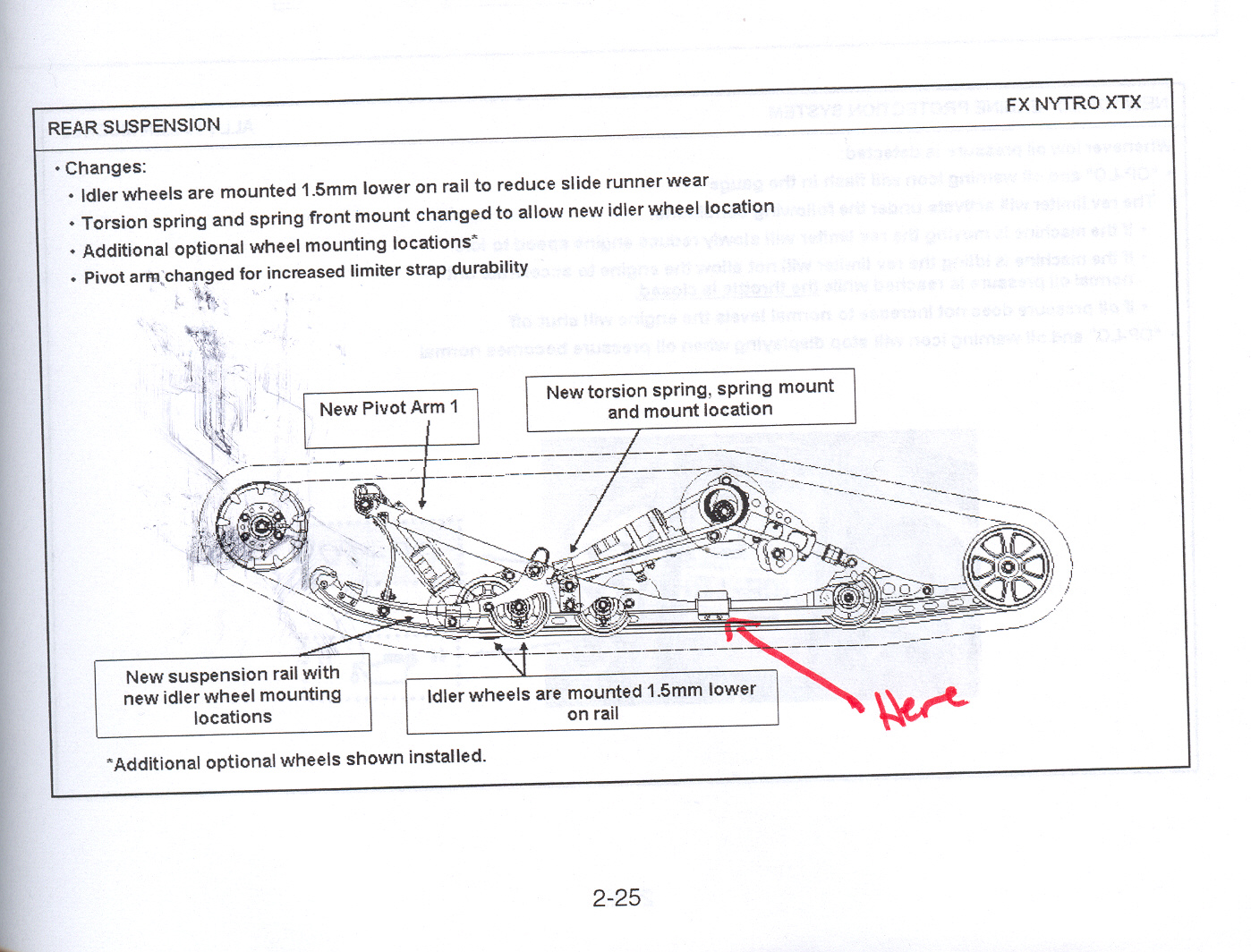

zeke-xtx
I only have 78 miles and mine need replacing. I sent Yamaha an email asking what Yamaha the fine company is doing about this issue. He sent me a pic asking me where the sliders are wearing (I will attach) and he knew exactly where they are worn out (my track is lose and we have good snow) I don’t think ice scratchers is the fix I think it’s a design problem and it sounds like I am going to get a small wheel kit from Yamaha gratis. I will keep you guys posted [/img]
he Knows the spot (they know about the issue)

I am not going to use the Yamaha guys name but here is a responce I got
"many Yamaha owners experience this problem. However, the trend seems to be that our hyfax do wear quickly, but only to a point, and then they stop and are good for many, many more miles."
So i said
"I dont like the idea of running something that is at the replace mark. I would never know when to replace them."
"If someone from Yamaha tells me (in writing) that I dont have to replace my hyfax when they are at the wear limit fine I will"
HE SAID
"You're right: we can't tell you in writing when to change your hyfax. As you know, I/we have to be very careful what we say here. You should always consult your owner's manual (which I'm sure you've done) but from everything I've read on the forums and heard from other owners, the hyfax wear slows considerably when it reaches the wear line. As you know, it also depends on riding conditions and riding style.
As long as the wear line is showing, you should be OK. Personally, if it were my sled and I could see 1/8 inch above the wear line, and there was some good snow, I'd go riding--but it's your call."
