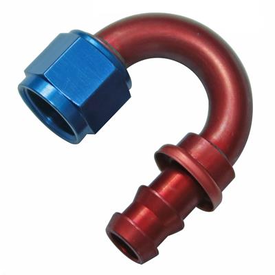

So according to this chart
www.onallcylinders.com
An 8an fitting requires about 25 ftlbs of torque. That seems a bit high. These are the fittings I'm using https://www.urotuning.com/products/...rb-fitting-8an-orb-5-16?variant=8311027433527
Apologies for all these questions, it's the first time I'm doing this.

Your pic shows an o-ring fitting, not a 37 deg flare AN fitting the torque chart was made for. I hope you have the right filter for this o-ring type male hose barb fitting.
You'll feel the fitting bottom into the filter - it will just stop. IMO, once it bottoms, I'd put about 15-18 ft lbs on it. With oring, it won't leak as long as it doesn't come loose.

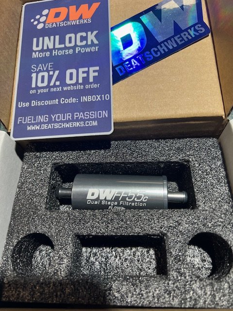

I think I found the one you were referencing.
DeatschWerks 5/16in 10 Micron 55mm In-Line Fuel Filter Kit
In-line fuel filter element and housing kit, stainless steel 5 micron, 5/16in hose barb, 55mm. Universal
Are you saying that you think that one is better than the Earl's one that I posted? If so, why?

That DeatschWerks DWFF55c inline filter shows that it flow 200 LPH which converts to 52.83 GPH. Is that enough for the stock fuel pump? I see that the Walbro GSS342 that most go to when they upgrade is rated for 255 LPH. I don't have a need for the Walbro pump at this time with my TD PowerTrail PM tune but I have no idea what the stock fuel pump flowsThis has the barbed ends. Easy pease.
Are you using this filter (or anyone that you know)?
