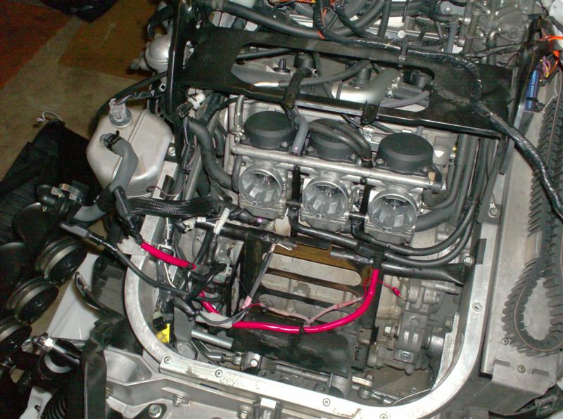

I guess it really doesn't show it in those pics I posted on page 1 but all of the above was removed and it was still impossible to get at(the one pic show the upper steering arm which is completely in the way)
