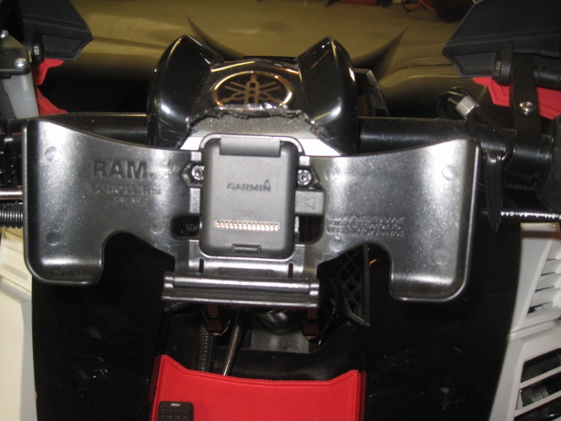

I have a Garmin Montana now too. It's about the same size, only thicker, than my old Nuvi here.
I considered the alpha mounts too. I ended up going with the Ram System for a pretty clean look.
Didn't want all that aluminum sticking out and pushing the Garmin further forward.
I use the Garmin Montana power mount so it would be plug & play.
I did wire a Marinco locking end to lock into the existing power outlet on the machine.
Never vibrates loose on the trail.
Here's the Ram Ball mount on the gunge pod.
I honestly don't see any benefit of mounting the Garmin power mount to the alpha aluminum bracket. May look cluttered. Remember, if you power through the USB port the unit is no longer water proof. The power mount bracket powers the Montana through external contacts.

Do you have a picture of your Montana on your sled?

Not a very good one, but the best I could find for now.

Thanks for the picture. It's pretty high on top of the gauge pod. I'm hoping it will fit under the stock sw windshield.

Yeah, not a lot of room up top. Stock windscreen barely covers the gauge pod alone.
Page 2 has a few pics you might be interested in:
http://ty4stroke.com/threads/stage-tuning-the-mid-height-windshield.145844/
Bottom line - no, the Montana GPS will not fit behind the stock windshield.
