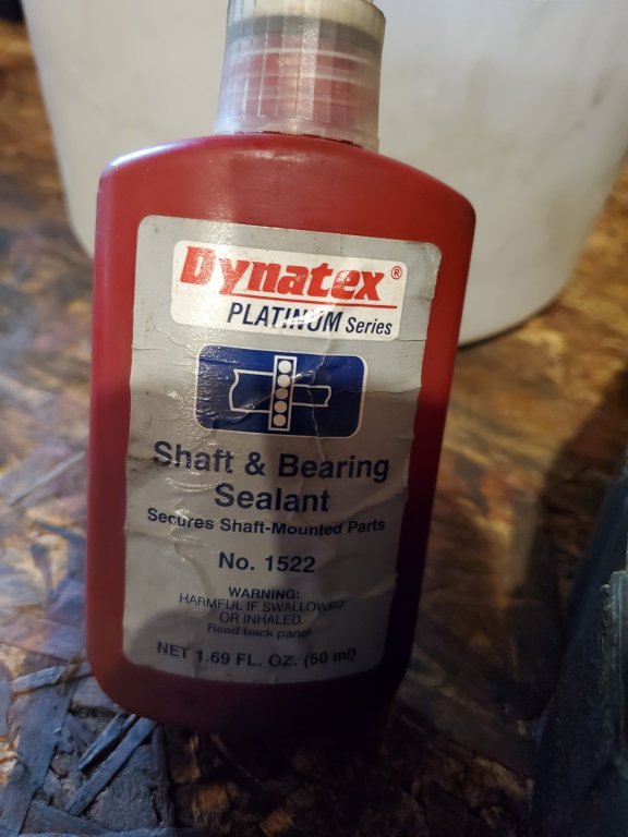

Re-assembly day... I used some Dynatex shaft and bearing sealant No. 1522 on the shaft and bearing race. Installed the caliper housing on the shaft and realized I forgot to install the brake rotor... oops.
5 minutes went by before I realized my mistake. Well do you think I could get the bearing off the shaft!! Not a chance lol. I decided to split the caliper to install the rotor and I'll deal with the bearing next season.
I don't think I'll have to worry about it spinning on the shaft this year especially with the wedge installed.

Should be good for 4000milesRe-assembly day... I used some Dynatex shaft and bearing sealant No. 1522 on the shaft and bearing race. Installed the caliper housing on the shaft and realized I forgot to install the brake rotor... oops.
I don't think I'll have to worry about it spinning on the shaft this year especially with the wedge installed.View attachment 155574

Would that be the same as locktight 680 bearing retainer?Re-assembly day... I used some Dynatex shaft and bearing sealant No. 1522 on the shaft and bearing race. Installed the caliper housing on the shaft and realized I forgot to install the brake rotor... oops.
DMCTurbo
- Nov 12, 2005
- 2,831
- 2,573
- 1,623
- Val Caron, Ontario
- 2017 Sidewinder XTX LE 137
I assume so, I had it in the shop and it says "secures shaft mounted parts" on it so I figured I'd give it a try.
