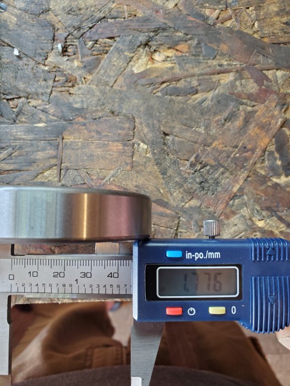

View attachment 155552 View attachment 155549 View attachment 155550 Repair completed.

I thought the whole reason for welding the shaft was to achieve a press fit??
Your caliper is showing .0035” clearance, that’s way loose IMO.
I asked for a tighter tolerance not a press fit. Maybe my made in China caliper as you call it isn't 100% accurate.
I'm happy with it, a little loctite and the wedge and hopefully it doesn't spin. I didn't use loctite last year on the first go around with the wedge. Lesson learned.
