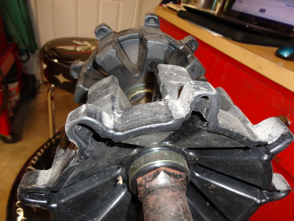

Boy your never satisfied! Lol!!I'll believe Mike but this this the 1st sled I've ever had that binds up on the stand. Like Cannondale I got rid of the extroverts. They climb the track but without them it doesn't happen. 1st sled I've ever run with extroverts. I've run 550 HP 1100 Cats on clay launching at 6000 RPM and didn't ratchet so I'm not worried about ditching them.
Regarding introverts vs extroverts i believe lead has nothing to do with the difference Never Satisfied and I feel so Mike is still correct. With the extros the drag of a sticky dry track has a tooth to climb onto vs intro which doesnt. Also these cheap extro drivers are molded. No Way within .010 accuracy and even if they are the extro tooth wears very quickly making the effort of the engineers pointless. Like I said when in snow and lubed I cannot feel the difference between the two and my results dont show it was worth the effort. But in my mind,clip wise and vibration and alignment wise I made the right move.

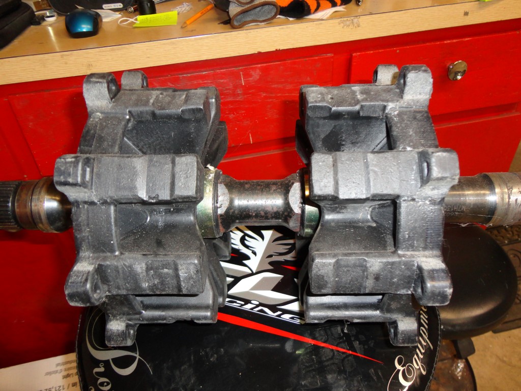

This is 6800mi original set. Too me it looks like the extros teeth were all that was driving most times and I run studs so track is fairly tight. You guys have way more power than me. Expect this way sooner. If want extros buy a good set like Wahl. Cat Extros are junk,clip eating Chinese quality. But they do work. Just not like they could if built right.

I agree with the post above. I have seen pics where it looks like the extros are driving the track. Most of the time it eventually rips the clip area out and the track is junk. I really don’t know why they have these drivers on all the new sleds other than the 2.86 pitch spaces the lugs further apart and makes it more prone to ratchet if the track is loose. I am not a fan of the 2.86 but it’s clear the 2.52 stuff is going away. There is no benefit to us, to me it was a cost cutting measure. Less lugs on both sides of the belt means less cost to produce and sell them at a higher price. Market they are better but there is no benefit.
Funny thing is my SRX ratcheted way easier than Viper with introverts. Especially from a jump landing.My original set was tweaked from the factory. Even being careful it’s hard not to distort them when installing. Now do it in a production line and anything goes. I know the guys at Hypersports true up every drive shaft after installing new cogs. They did mine when I raced and I never had an issue. Just can’t take much off.
